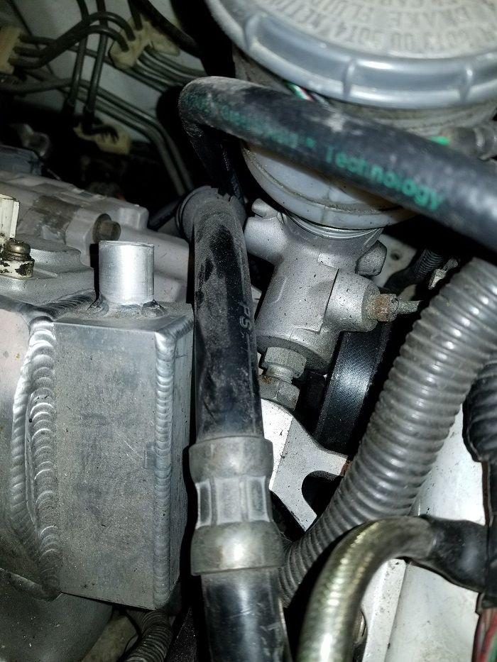

I am looking for suggestions/options on how to approach replacing the head gasket on my JRSC setup.
Info:
94 Integra GSR
LHT+JRSC
My first intention was to pull the motor/trans out of the car so I don't have to spend the extra time like a flipped turtle, finagling under the car, So as I started disconnecting things in the engine bay, I noticed the brake master cylinder reservoir will be in the way of removing the engine directly up and out. Looks like the snout of the charger will interfere.
So i figured maybe, with the engine hoisted, I would remove the mounts and lower the engine down and towards the transmission side and then towards the front of the car to get the snout of the charger to clear the reservoir and then the engine+trans+jrsc would come out willingly.
I could also just pull the blower off the manifold and then just remove the head without removing the engine.
My ideal goal is to spend less time banging knuckles in between the block and the firewall removing/reinstalling the charger while it's in the car if it makes sence.
Suggestions appreciated!

First off, I love that 12/14mm ratcheting wrench! In regards to your dilemma, sometimes the fastest way just so happens to mean, taking off more parts. If it were me, I'd do this: Compression and leak down test the engine. Make your decision from there. If anything out the ordinary is found remove, refresh, reinstall. If it's all in good health, start banging those knuckles. Either way, pulling the motor and adding some fresh seals wouldn't hurt either.
Best of luck,
Joel

Thanks for the replies everyone. I'm going to track down a compressor to do the leak down test and then go from there. I have good compression, but the coolant reservoir keeps filling up and and the car has tried to overheat a few times while idling.
I'm also diagnosing an insane misfire as well. All components in the dizzy tested within spec., but the firing sequence for some of the plugs is very erratic. As far as i've been able to diagnose, it's a bad dizzy or bad ecu. ECU is A P28 with s300. When i jump the ECU I get a steady on light. No flashes.
Car ran fine for a little more than a year... until it didn't.
Mo' Honda, Mo problems

So I did the leak down test today. First air compressor I rented from a local shop was crap, but fortunately I was able to source another. Tests are illustrated below.
So the exhaust valves on the #2 cylinder seem to be the culprit. Airflow coming out of the exhaust.
(And no, the cherries coming out of the valves are not the problem)
I'm glad I took the suggestion to pull the brake master cylinder. This proved to be quite time saving and the head came off with ease.
Just another head-less Honda
I'm leaning towards just replacing the two exhaust valves with oem Honda parts. I looked into going aftermarket, but i'm on a stock exhaust cam and type-r intake cam and gsr valvetrain so it doesn't seem to really be necessary.

A valve job is in that plan correct? I hope so. Replacing just 2 valves will be fine. Find a friend with some ITR valve train, if budget permits superrich has the ecno stuff.
Resurface if need be, valve job, valve seals, have the guides checked ( exhaust usually are the worst ) if your machine shop doesn't do that automatically then find a new machine shop. I'm an over planner sometimes. I tend to get caught up in the "lighter valve train" hype; every engine I tear apart and reassemble gets new valve train hehe. Other than that, you're looking good.

I ordered the valves and head gasket from Honda today and will likely take the head down to reputable local shop I've used in the past. I'll have them go through the whole thing and see if they find anything else that needs replacing.
ARP studs coming next week as well.
