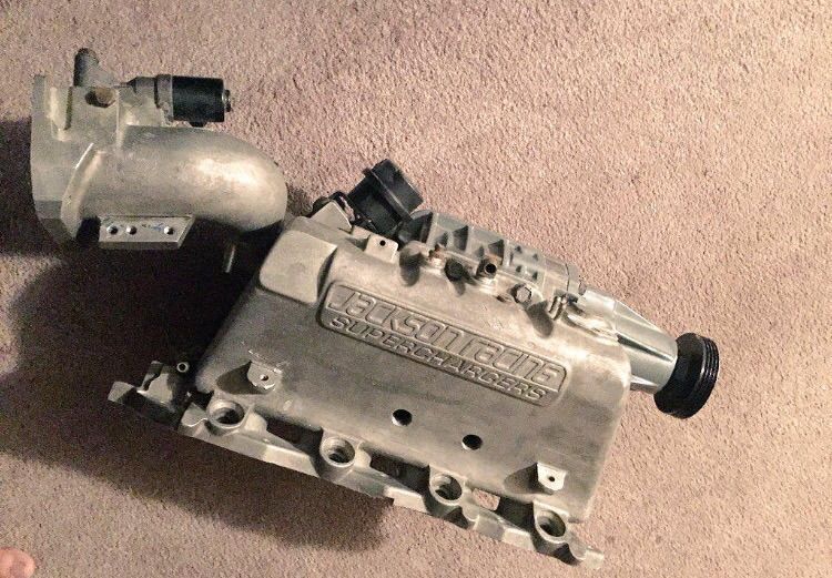

Hello guys,
I'm having trouble trying to get all the things I need for this supercharger.
I don't have much knowledge on this I just know there's belts, pulleys, and other stuff that
I'm wondering what exactly it is I need to complete this set up.
I don't know which belts and pulleys I need or where I can find them to purchase them.
If anyone is willing to show me into the right direction I'd greatly appreciate it.
this is the first time I've tried to supercharge my Civic.
I'll put a pic of what I have so far which is basically only the Jackson Racing Supercharger.

You need a bunch of stuff. Tensioners, alternator pulley, belts. That's pretty basic. Have you already purchased this ?

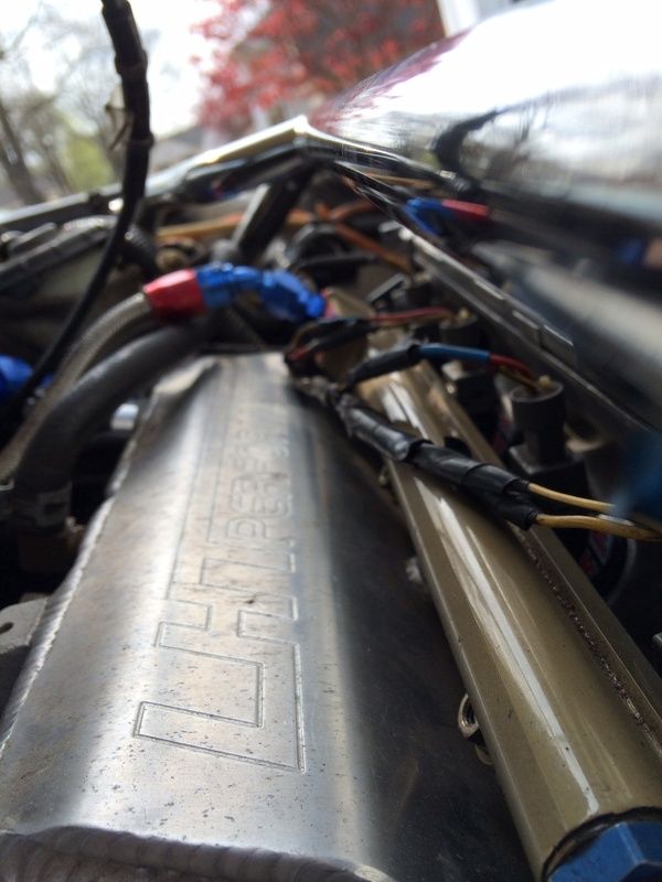

TFW = This Face When
My LHT kit required grinding my studs WAY shorter in order to get them to thread into the mount holes. So short that there wasn't anything left to thread a nut onto with the stock rail (which I had to grind the sides off of). So, then I had to mill the rail tabs down and then counter sink them to use a cap screw.
Stock stud in background with maximum allowable length in foreground:
Nothing left for a nut to grab on to once the rail was installed. I later realized a nut didn't even fit.
The solution milled the centers of the mount tabs and counter sunk them so we could use allen screws since traditional bolts didn't fit. I think I was grinding a bit more off the sides in this picture:
Final fit:

oh okay thank you where about can i purchase them if yu know? yea i traded someone a ps4 i never really used lol.

There is no single source to get all of the parts that you need. Moss Motors and Motorvations Motorsports are the two places to try first.

I'll have to compare that with mine now that I see what you did/are talking about

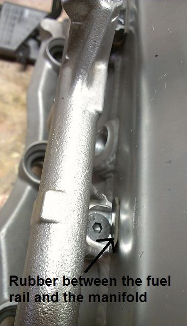

mine looks nothing like that - fuel rail fits very well compared to yours - still not ideal.
it would seem they have made some improvements, but the leaking I can't condone. :/

I'd check with MVM and Moss like JRCivic said for the originals first. If you don't have any luck there and you don't mind aftermarket.... you can grab this set to complete your setup.
Jackson Racing supercharger bracket kit B-Series eBay
