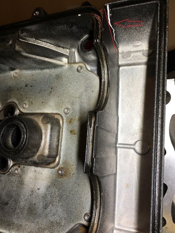

Just received this p72 gsr head from a reputable dealer which i'm not going to mention at this time until i get some opinions. Paid $700 shipped. When i 1st purchased it was suppose to be a fresh 2000 gsr head that he was going to take off a b18c because bottom end was no good, told him great he hooked it up i paid and waited for head to arrive which he said in about 2 weeks he still had to take the head off, i said cool can you ship me tracking # and invoice to my email. I contact him to get a follow up and so he can resend the tracking # again cause i never got it, he fixed my email was a letter missing, i said thanks.
So i call him up again to ask him what's going on with the head, and he tells me "Hey my shipping guy shipped you the wrong head, it's actually a little better it's already been machined and it also got new valve stem seals installed by my machine shop, so go ahead and keep it, i was like cool man thanks, does it still come with the valve cover he's like yeah you still get it. So i was thanking him him for the hook up you know what i mean, Any way i got the head yesterday and started inspecting and i think it's no good, help me out guy's. I think this head a 96 not a 2000? does it look to be machined? what's with the 2 different valves? also valve cover was cracked and their are some rough casting marks (pictured with red arrows).

1996 year model obd2 gsr head(cast in 1995.. can tell by the studs, two new cheap *** valves, previous cobustion damage prolly from old valves bending/motor blowingup... re surfaced
Casting date clearly shows July 16th 1996. I would send it back with those mismatched valves and combustion chamber damage.

Exactly what people are telling me, return it back, get refund!! Also has a couple of broken cam bolt cover bolts with half stuck in the head......

The way OP wrote it, it doesn't sound like it came from HMO but from some other shop. Broken cam bolts in the head too? That's some serious junk they sent you.

Maybe unlikely but perhaps they accidentally sent you a core return?
