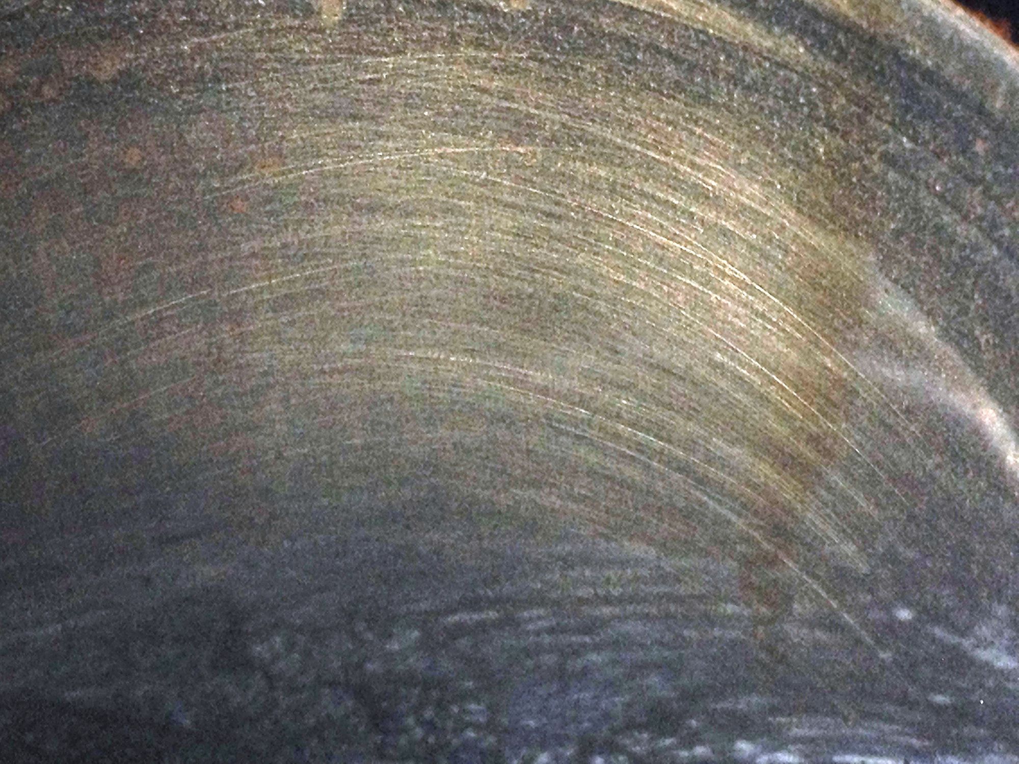

Are you concerned about removing too much material from the bore with the ball hone? Thank you for the caution.
All I want to do is remove glaze, give the bore a fresh surface.
Here is cylinder after removing pistons - everything measures w/in spec:
I am not 100% the finish of the ball hone is going to have the correct angle and roughness finish that is ideal for ring seating. Ive always believed that machine work should be done by machines and no matter how skilled a person is, you cannot get what a proper honing machine can do. Some people have used them successfully im sure. I have not. I suppose since you measured the bores before and after and they're all in spec, you'd have a better chance at it working well....But there's that surface finish Ra thing and crosshatch angles (stroke and rpm have to be consistent and near perfect) that I'm just not convinced a flex ball hone and a human hand is the right tool...
Id consult a couple different machine shops and pro engine builders to get their expert opinion too..
From everything I have seen and read, the ball hone is the best tool for the home DIYer. The old schoolers used to use the tri-block deglazer back in the day but it was replaced with the more expensive ball hone.
I think the important part is to get the right compound and grit on the ball hone for your application.
The ball setup helps improve your cross hatch angles and since everything is in spec and you can see the original cross hatching, I suspect 4-6 short passes with the correct ball hone will be all that's needed.
If you visit flex hone's website (brush research) they have a document to explain the various flex hones available and what applications they are best suited for.
I personally plan on using a flex ball hone but also plan on getting a drill press so that I can control my depth and height a lot more accurately.
Other than that, I've heard nothing but success with the higher costing flex hone ball hones.

I only did a couple of passes per cylinder. I was cautious about running the hone too much. I was also dealing with a cordless drill that had a battery that was about to die. So I would hone 1 cylinder, throw the battery on the charger, go and work on the yard for a few minutes, and then on the next cylinder.
Yes, I do wonder about the correct angle of the cross-hatch, but at least I got the correct abrasive, as per Honda guidelines.

Originally Posted by 94 Civic Si
It looks like there is a hairline crack in that sleeve from the pic. I hope it not cracked and it's just lighting or something.
Old 02-23-2017, 12:06 PM
Premium Member
94 Civic Si's Avatar
Join Date: Mar 2004
Location: Estados Unidos
Posts: 2,962
Received 189 Likes on 164 Posts
Default Re: Initial Start Up - Break In Rings? Or Burp Cooling System? B18C1
This? A surface scratch from when I was checking ring gap...

Originally Posted by turbociv910
that hone job looks like it needs to move up and down quicker.
I was thinking that too, didn't look like the solid 60 degree angles it should have, but wasn't confident in my opinion to say.

The pictures with the arrows? That is pre-hone.
I wasn't sure if this was purely an engine assembly question, so I started a new thread here:
https://honda-tech.com/forums/honda-...b18c1-3293564/
Now I am convinced I have an engine assembly issue, so I will start a new thread in this section.
