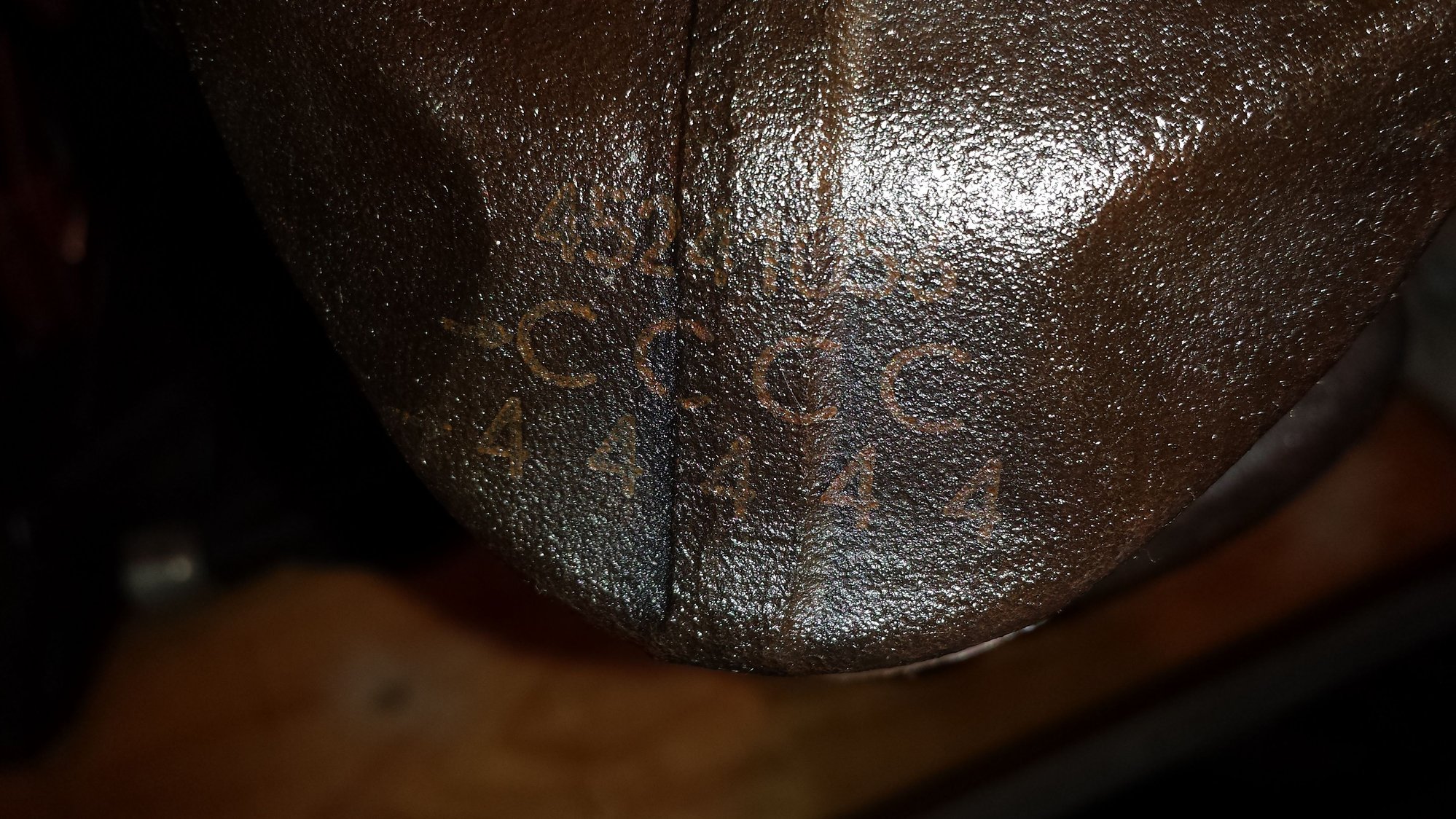

Now here in this 3rd pic you can see, on the accessory end of my crank, that it's been stamped or lasered with CCCC and 44444. Which I believe, and plz correct me if I'm wrong, are indicative of letter "C" for the rods and number "4" for the mains..? The problem is I'm NOT 100% positive and that doesn't work for me. So does anyone know if this ^^^ is where F series cranks are marked? And are these marks indicating what I think they are? Also, I know my OEM rods were stamped with numbers like the ones in the thread above but tbh I can't remember what that number was? And my block stamp is "BCBCB" which, if I'm correct in my assumption and according to the thread above, would indicate my engine came from the factory with "BROWN" and "BLACK" main bearings, respectively. Right? lol! Anyway fellas, as always any insight will be greatly appreciated, and thank you all in advance.

What does the chart in your service manual say? I usually just stick to that in case there are slight differences across engine families.
