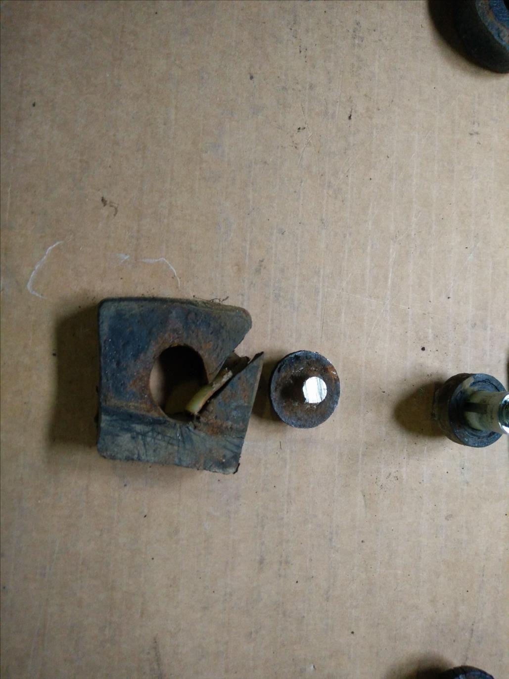

The tier down has resumed! It took me some time to find a location where the car could stay for a while (more than one or two year).
I have had some issues with the bolts between the body and the chassis, 2 of them have broken and I will have to remove the seized thread. I took a lot of picture to remember the way it is installed especially the electric harness.
As already experienced by other the configuration of the car is different from the parts list, it is a mix between S600 and S800, for example the clutch has mechanism from S600 and the slave cylinder from S800 with dedicated push rod. The hinges of the bonnet have little O-ring in each screw that are not in the parts list.
The most difficult will be to find and replace all the rubber that are not usable anymore.

see two pictures of the o-ring on the hinges of the bonnet in each screw that are not in the parts list..
