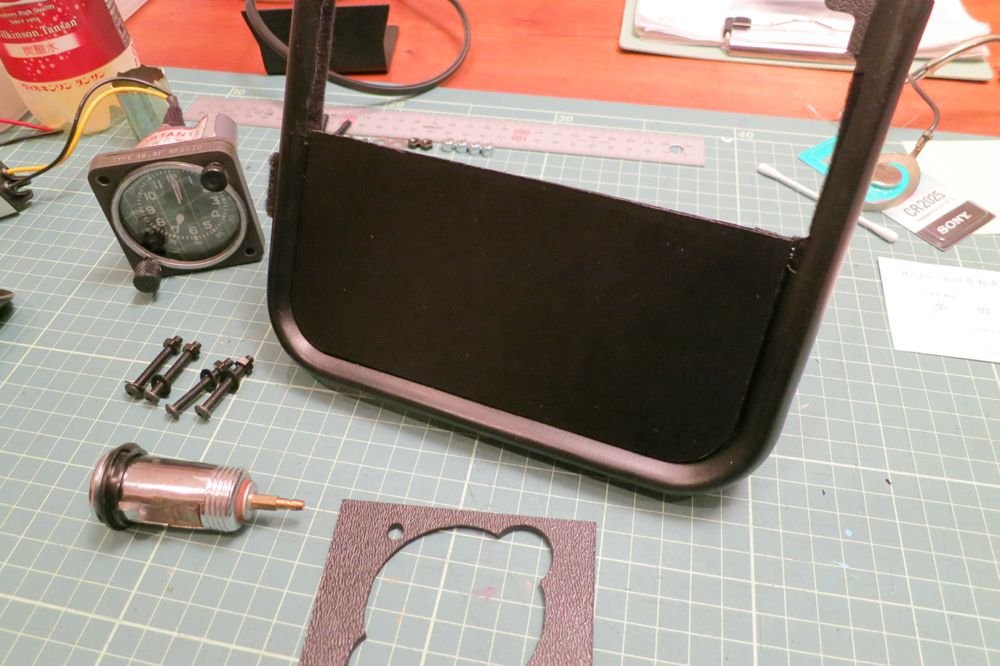

made a nifty clock from a 1955 Machmeter. also fitted a stopwatch the same as used in the Red Arrows
top left corner
plan is to make it look the similar to as it was but without the graphics.

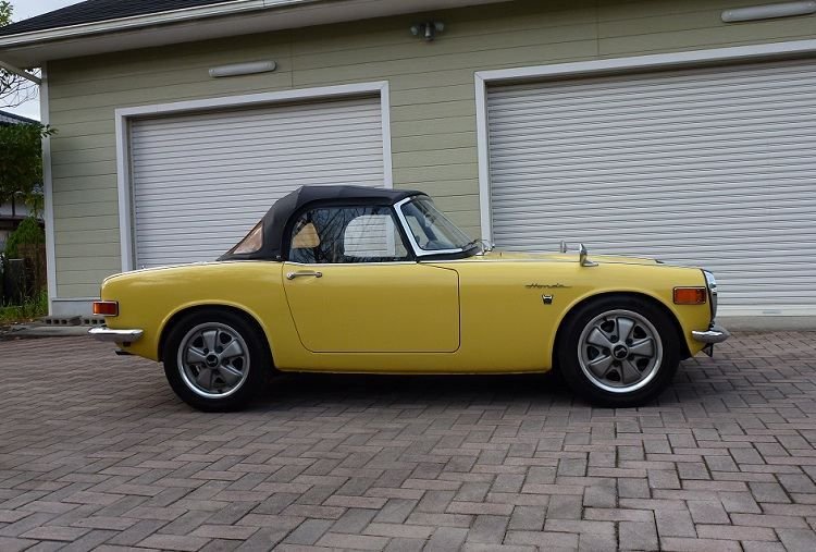

even though the S800 is supposed to have competition history, no one has found it yet. the previous owner had known the car since the 80's and didn't know it had been bright green at one point in its life.
iv'e got quite a history file with the car from 1989 which shows the 52,000 miles, which is probably genuine, as it had spent 12 years in storage between 1992 and 2004. it has holes in the bodywork where it has had a roll cage fitted at one point but nothing about any competitions. it was reregistered in the 80s so did have a different registration number. the old number was LTV640F but that comes up blank.
these photos were in the history file with the car and hopefully the aim is to getting looking pretty much the same
