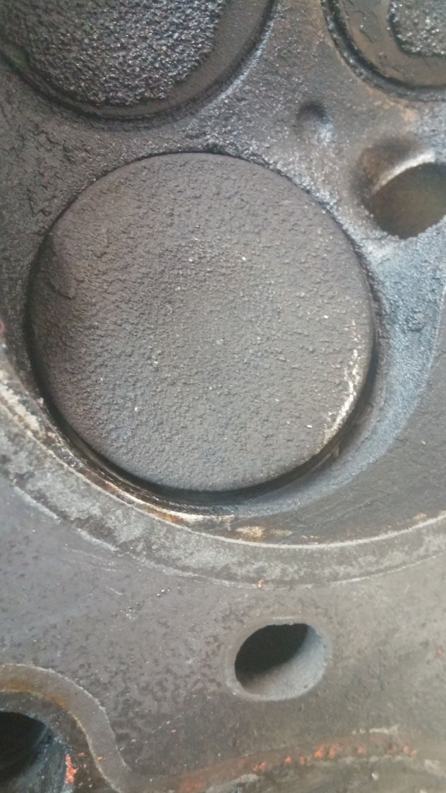

This is the first cylinder, and number 2 and 3 look like this

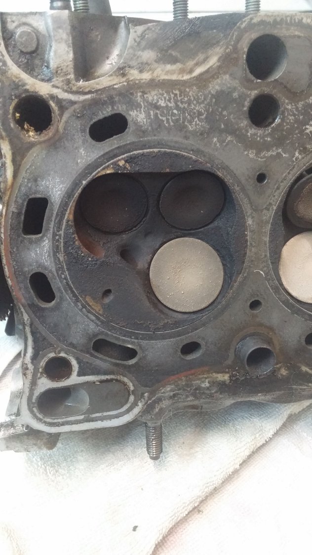

Cylinder 4, the one with low/no compression. The exhaust valve looks a little different than the other exhaust valves.

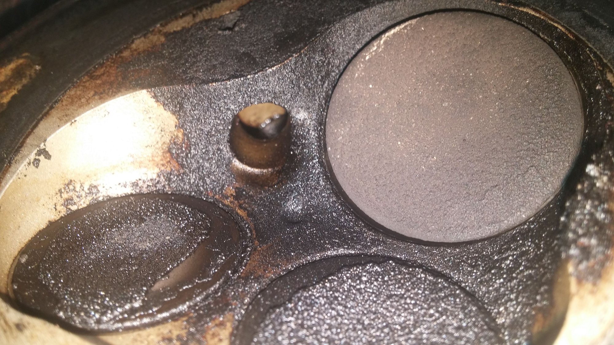

closeup of cylinder 4 exhaust valve
cylinder 4 auxiliary chamber. It has less carbon deposit in and around it than the other auxilary chambers

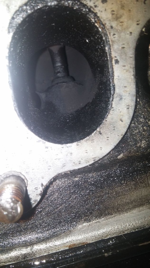

cylinder 1 through 3 exhaust valve stems look like this.

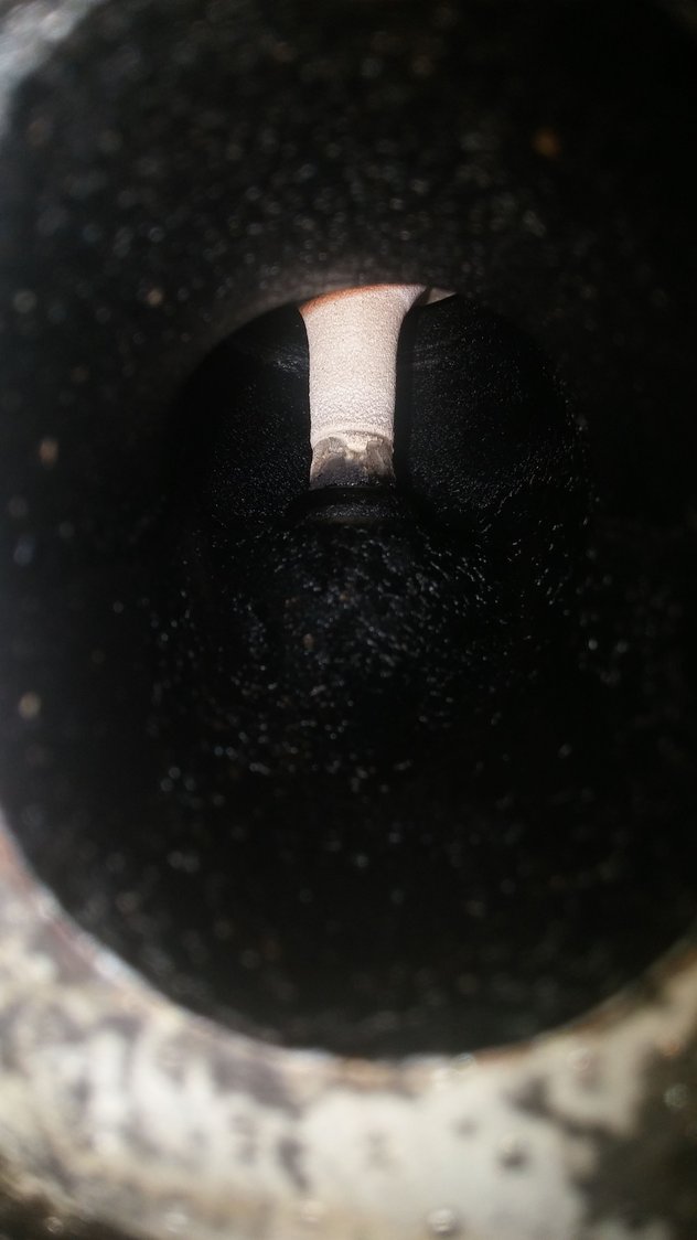

cylinder 4 exhaust valve stem<br/>

All of the intake stems look new. The carburetor looks almost brand new, and the cylinder walls are great. I was thinking maybe the distributor could be the problem, or the valve seat, because the valve looks to not have any cracks, stress, or pieces falling off. It just doesn't have the white deposit on it, and the combustion chamber has less carbon deposit.
