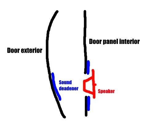

I keep the original foam ring on the door panel if one exists. For the sake of anti-vibration, I make a gasket of hush-tape, dynamat, or similar aftermarket sound deadener. With the hole I cut in a square of that, I place the circle inside the speaker hole on the inside of the door skin directly behind the speaker. Hopefully this cross section helps.
