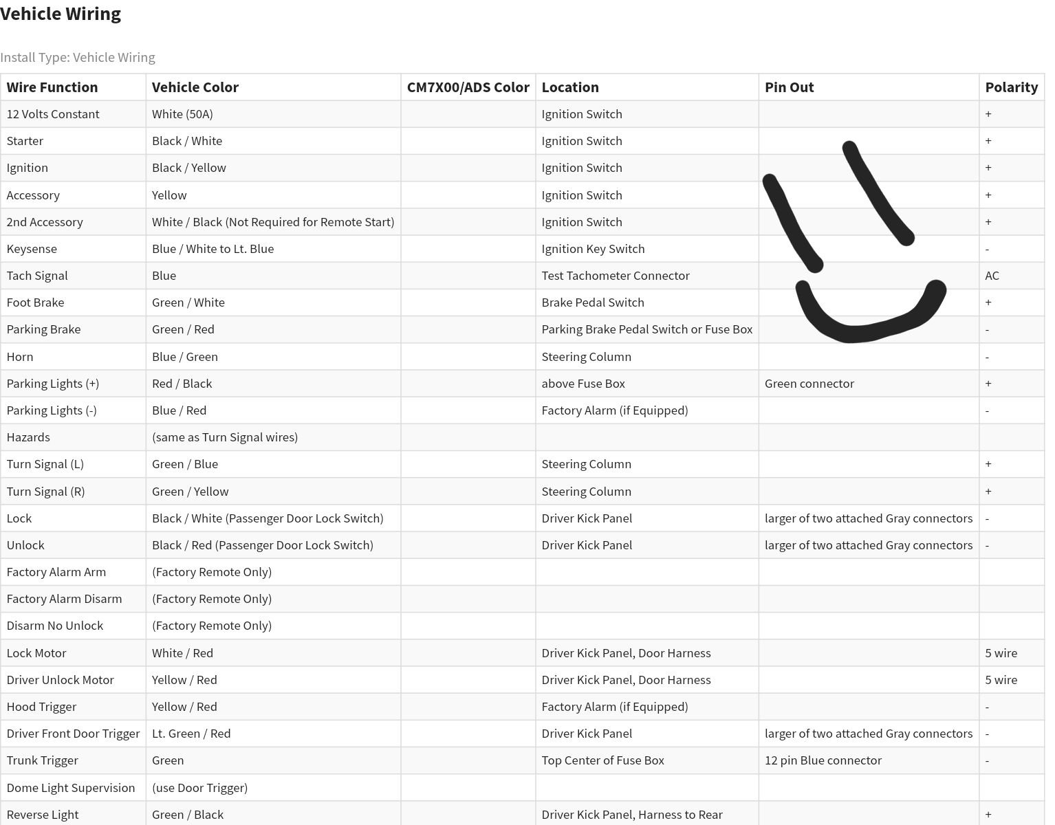

I'd actually recommend using the wires going to the ignition switch. They are more accessible, mainly, and longer to work with. Just had to fix a kill on the relay on the 99SiR I'm doing and it was a bitch to solder the like 2 inches of wire.
But, y'know .. that's where us lazy/incompetent installers would go. I mean, the diagram below is from one of the largest most reputable manufacturers of alarms and starters and that's where it recommends..but hey..
Take your pick:
