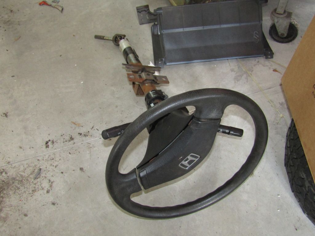

Steering column removed

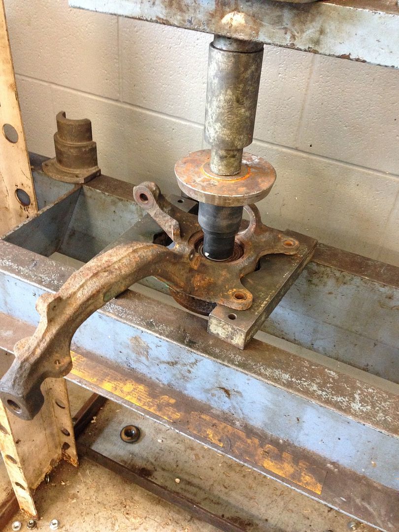

Pressed out the old hubs
