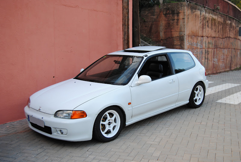

Bought the car in 2009 summer, the previous owner was a mid ricer but the car wasn't bad at all so we can say that I saved it.
So '93 frost white EG6, 160.00km on it, sunroof, ac, etc...

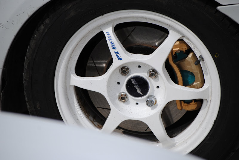

I couldn't afford something like volks or rega so I think that one of the best price/quality are the buddy club P1 racing, I matched them with toyo t1r.
car had a ricey air filter, I found an oem air box, bought mann filter. Engine sound improved and definitely I was lossing hp with that **** hot air intake
front brakes were very worn so I get e'spec 282 discs with the caliper relocation bracket to use the stock calipers, e'spec pads too.
Calipers free the rim almost by miracle, I managed to relocate the rim wheights because they scratched my calipers on first meters.

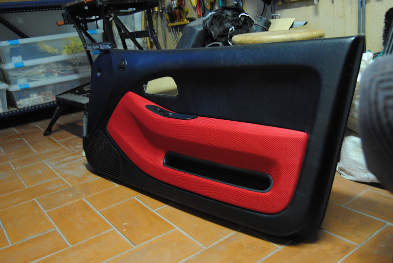

slightly mods, door panel inserts, amber corners...

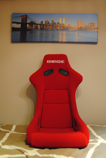

I managed the recaros, and mounted the oem seats, ****! they are ****ing chairs. I get a bride replica to replace driver seat.
with temporarily fixing system...

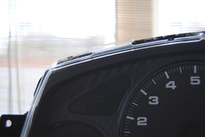

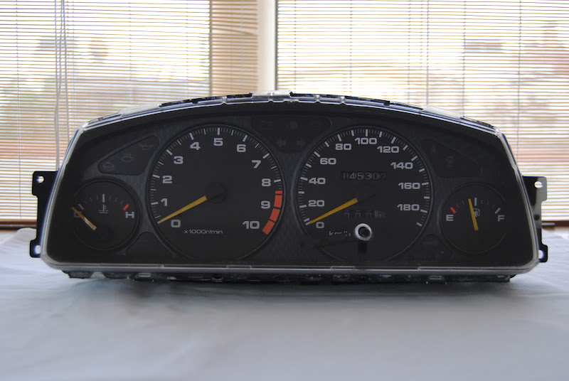

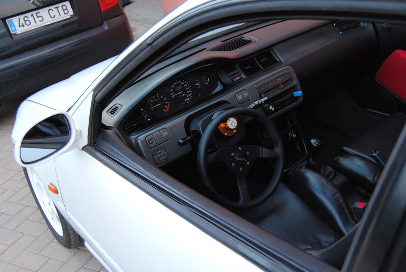

And this is a stuff have been working on some time, dc2 cluster into my eg.
you know it's hard to find an integra cluster connectors, nobody wants to sell you them and get his wire loom without, so you have to buy the entire wiring that means $$$ for only a pair of connectors, so I was thinking and had an idea.
first harness to test it on the car.
worked ok so I redid it to one more well done.
plug and play baby
trip solution (3 diferents version of the piece)...
here it is, like oem

car looks good just curious u sure its an eg6?
from what i know, eg6 comes with climate control, standard white face cluster, folding mirrors? though i might be wrong...
but car looks good and the cluster swap is sweet!
Old 08-04-2011, 03:03 AM
DiSCLAiMER's Avatar
Join Date: May 2010
Posts: 104
Received 4 Likes on 4 Posts
Default Re: Europe poorboy EG6
well... that's the jdm version, here in europe honda sold the EG6 with B16A2, of course without things like you say, but with a b series.
I think that in USA you haven't an eg with b series from stock isn't it?
car have EG6 letters on his serial number vin

Those dials look great! Did you end up re-pinning the blocks? Is it 100% functional?
Old 08-04-2011, 12:25 PM
DiSCLAiMER's Avatar
Join Date: May 2010
Posts: 104
Originally Posted by e-eg6
Clean eg man..
fully working, I used the cut female connectors from the eg cluster and his circuit board, some soldering, some wires and patience.
