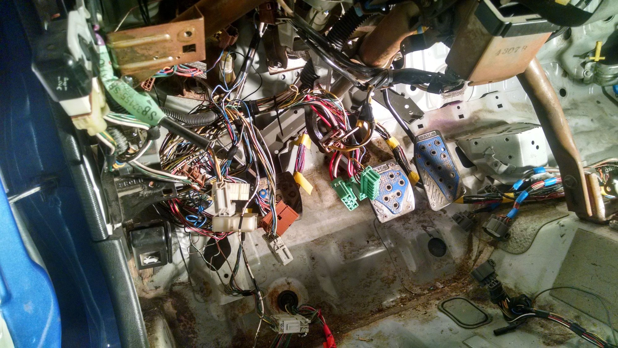

Dealing with this nightmare at the moment. The previous owner hacked the body harness pretty good. One more nest to clean up and then I'll test everything
Slowly but surely I de-pinned most everything that didn't work or had nasty cut wire with split offs -_- going as bare bones as it gets except the sunroof.

I managed to get enough sorted to hook up the battery. I have tails, headlights turns without the dash on, and when I turn the key over I get a click at the relay!
So I'm happy since I lost ignition power and had a spark issue within the distributor, so all should be fixed with s new distributor and working ignition switch!
Prior to me getting into the entire body harness it was a nightmare with splices, dead wire and non working accessories..
Since then I have trimmed out what I don't need/didn't work to keep it simple since the car won't be a daily driver..
I have managed to nab a stock uncut ej1 body harness for sakes of having or needing it if I want to ever sell the car
I have power again!
