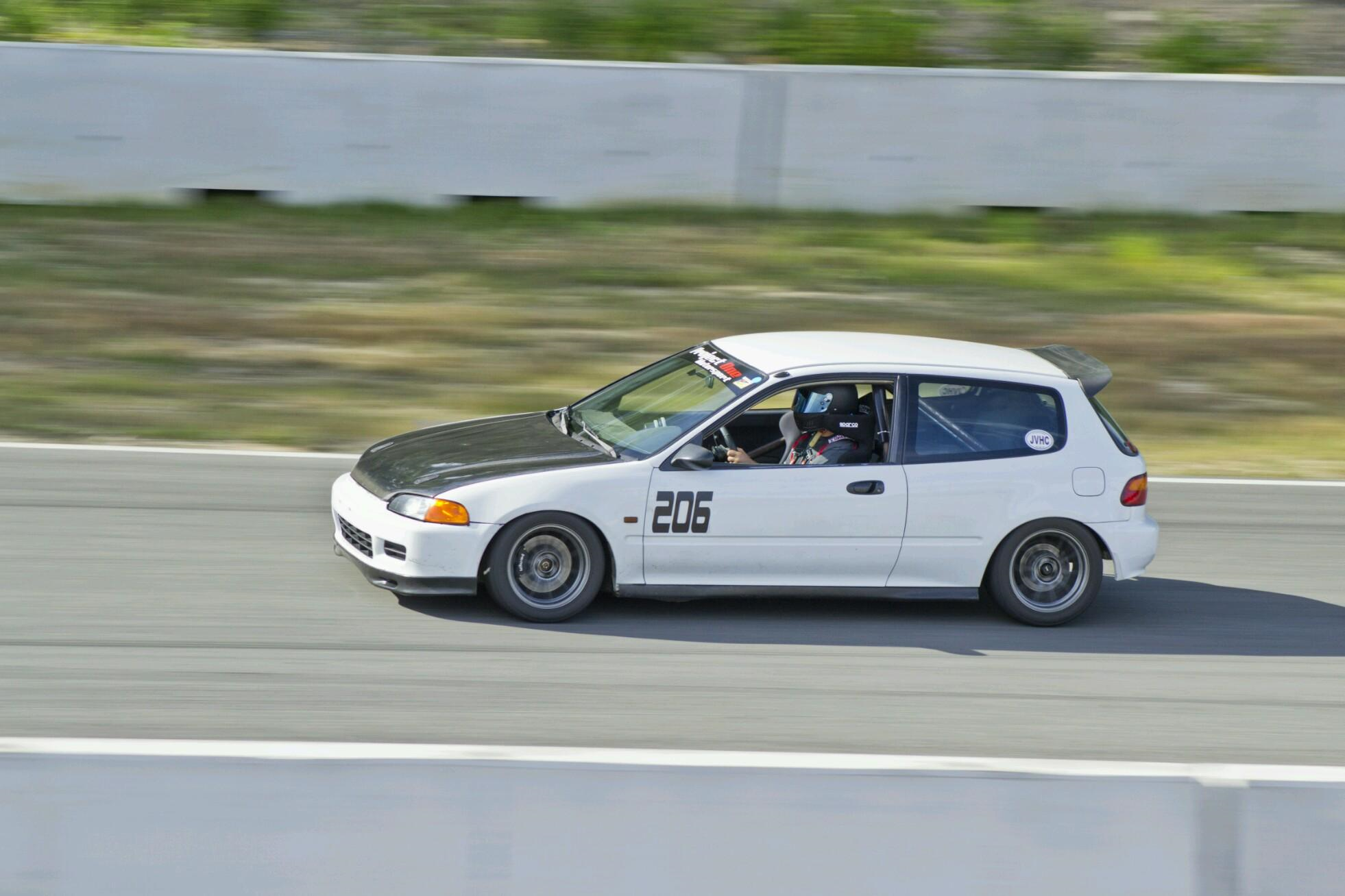

Palmer Motorsports Park was a lot of fun last weekend, met some new people and ran into track friends as well. It worked out pretty good, we got there Saturday night at around 7pm and unloaded the cars and got them ready for Sundays HPDE. It rained for 5 minutes and then the sky turned bright orange and pink and with the track in the background it was a nice site. Overall the cars had no issues and the track time was good. I did how ever get black flagged for exceeding the tracks sound limit of 100 dB, my car was caught at 103 dB even with my silencer. I was able to talk to the track officials and get back on track for the 3rd session but they warned me and said if i get black flagged again that I will be kicked off track for the day. I tried my best to drive the car as quiet as I could but once my friend Marc got closer to me I got black flagged again lol. For my 3rd session I shifted the car at 6k and also gave it half throttle going up the up hill (turn 5) and then the back down hill (turn 8), as well as the straightaway. Even though i felt slower in these areas I felt faster in others because maybe now that i was going a bit slower i was able to focus better on getting my lines right. My best time of the day was a 2:00 and my average was 2:01.
Here's a few GoPro videos and some pictures. Looks like the next track day that we are aiming for is Watkins Glen at the end of August.

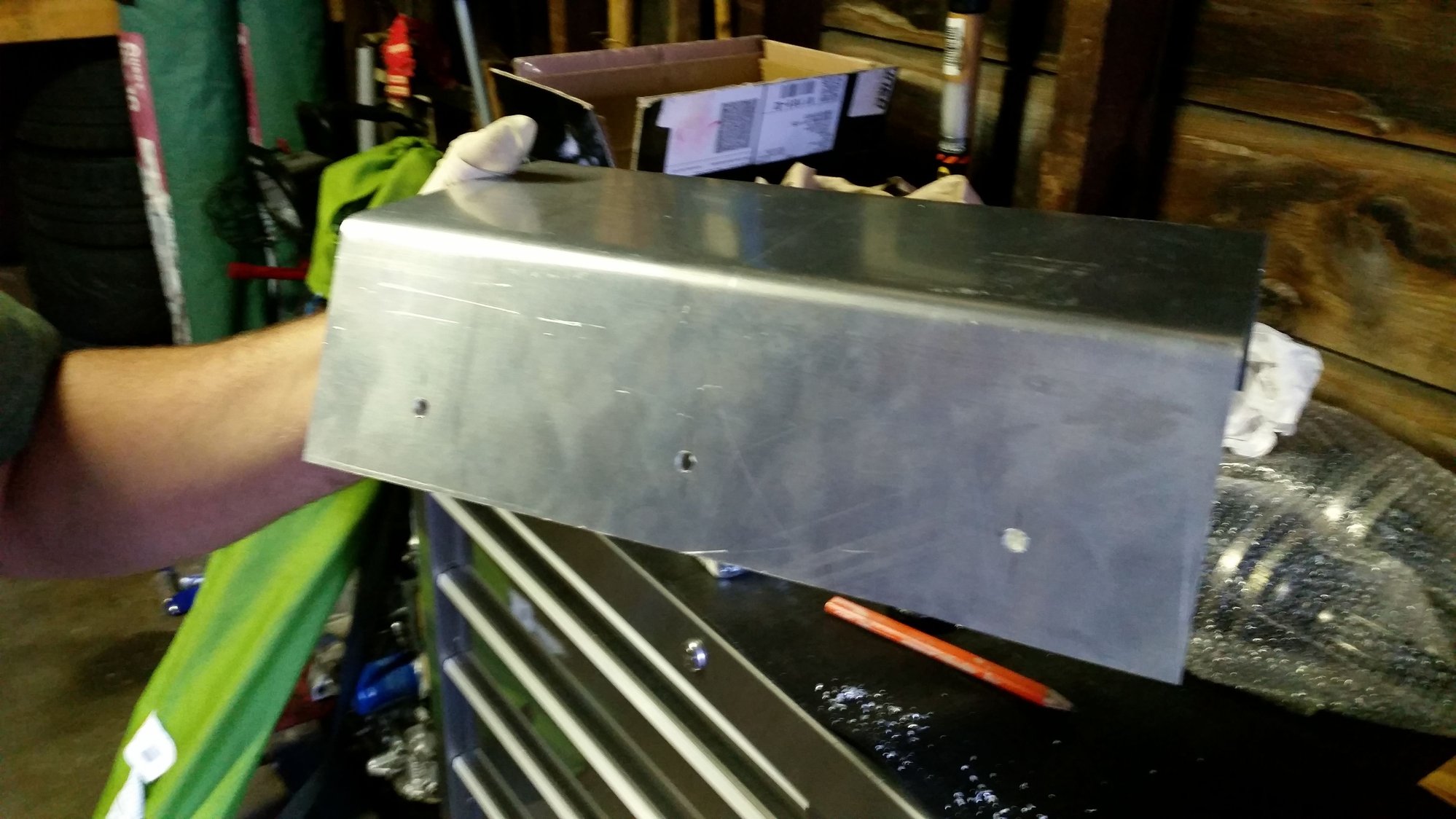

This weekend my buddy Rob and I installed the ktuned shifter box that I've had for months lol. I originally cut the exhaust tunnel to mount the oem shifter box from underneath so Rob made a mounting plate to cover the hole and install the new shifter box ontop of that. I'm using the oem rsx cables for now but plan on buying the race spec cables.
