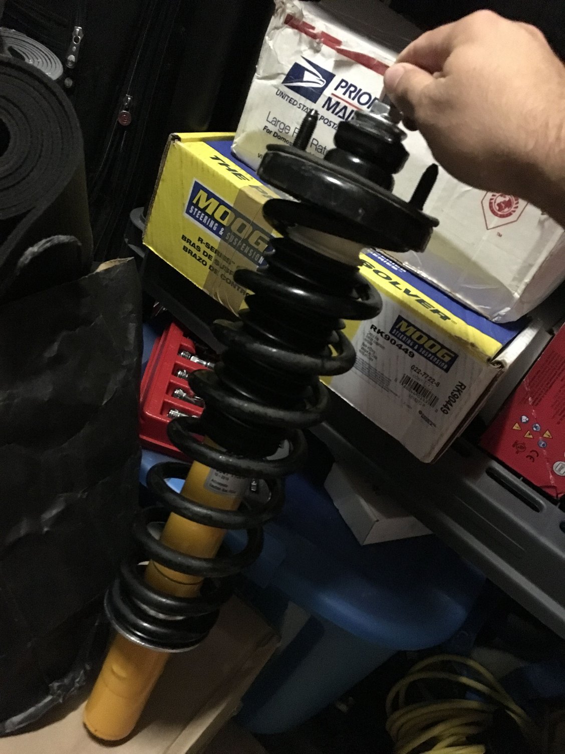

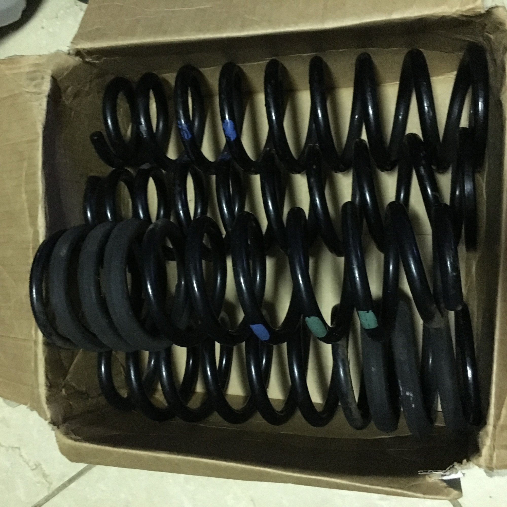

While I was at it I ordered Koni yellows for a type r since I also had the lower control arms coming in

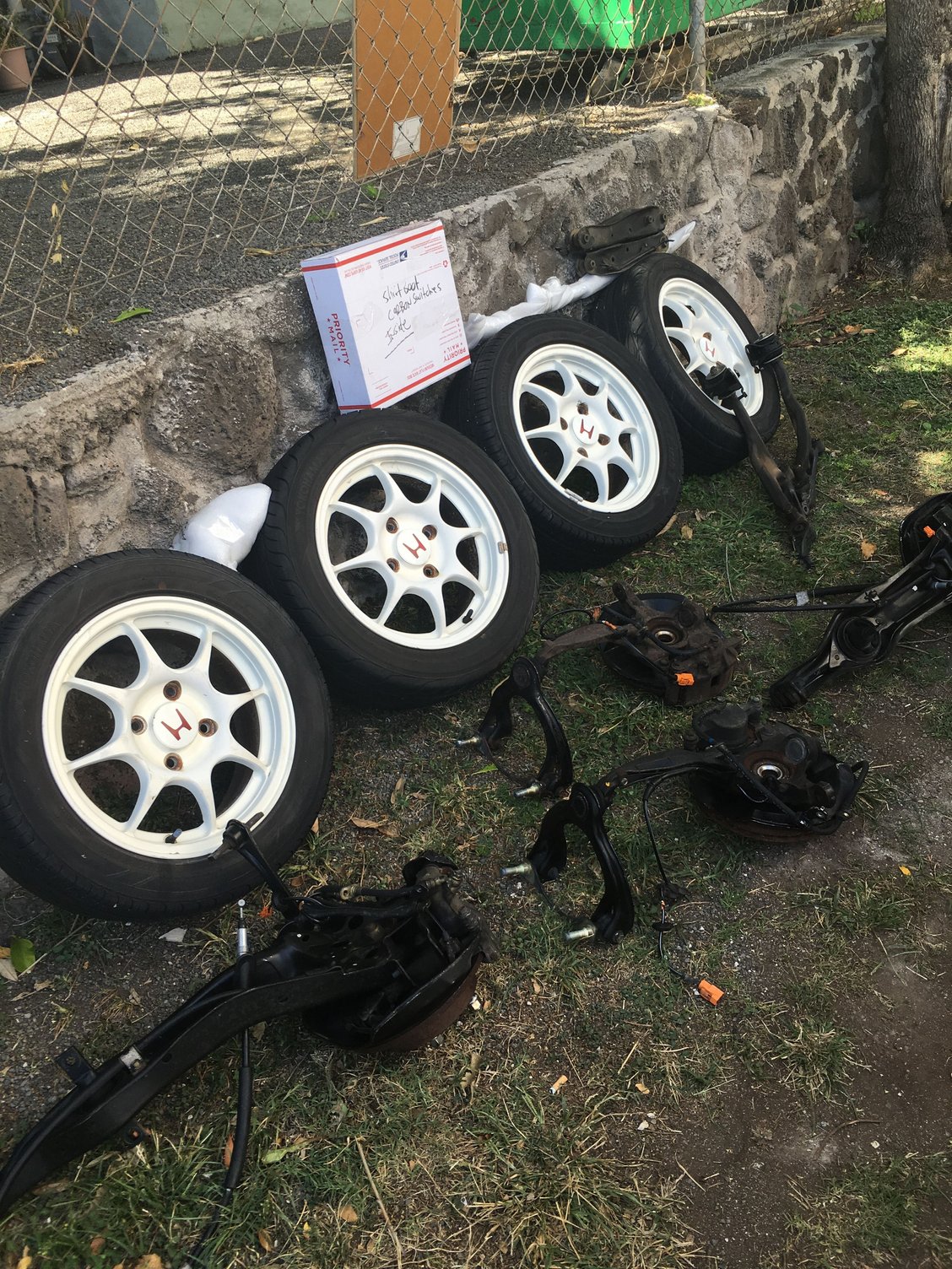

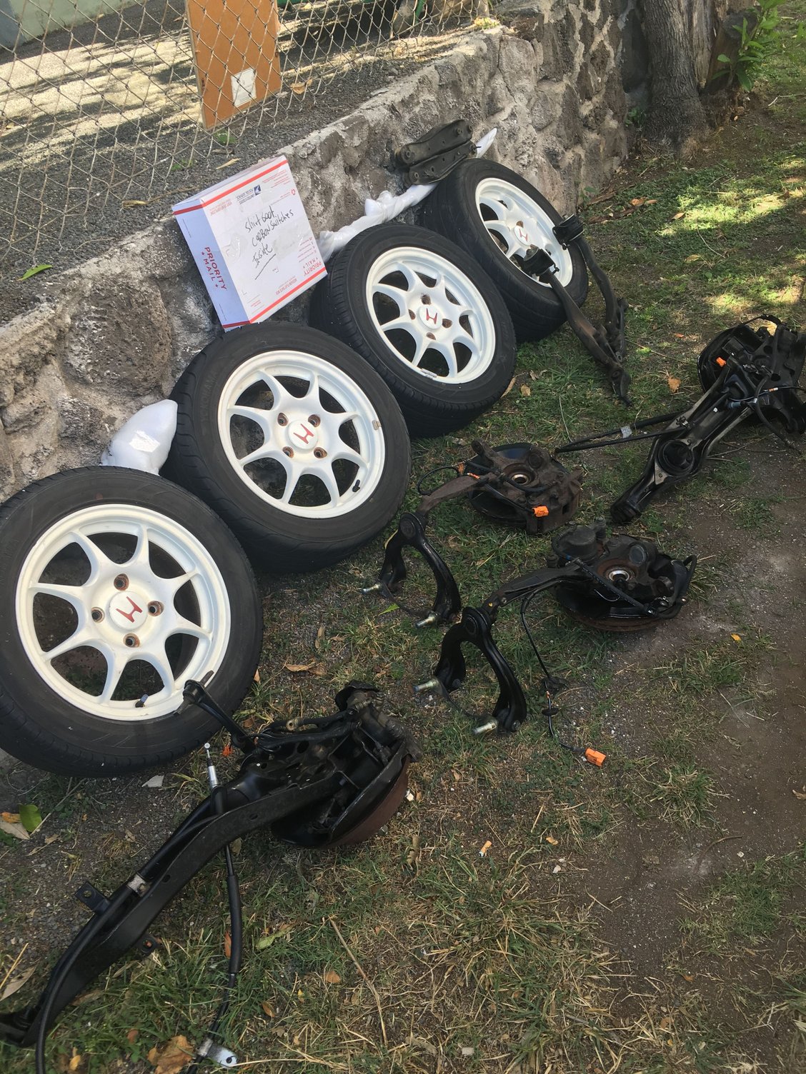

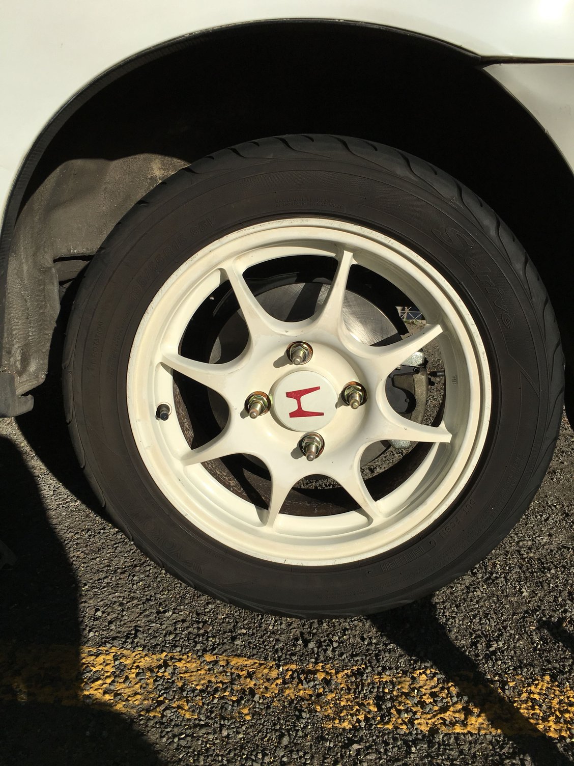

After waiting 2 months my 96 type r 4 lug and rims came in along with some other goodies

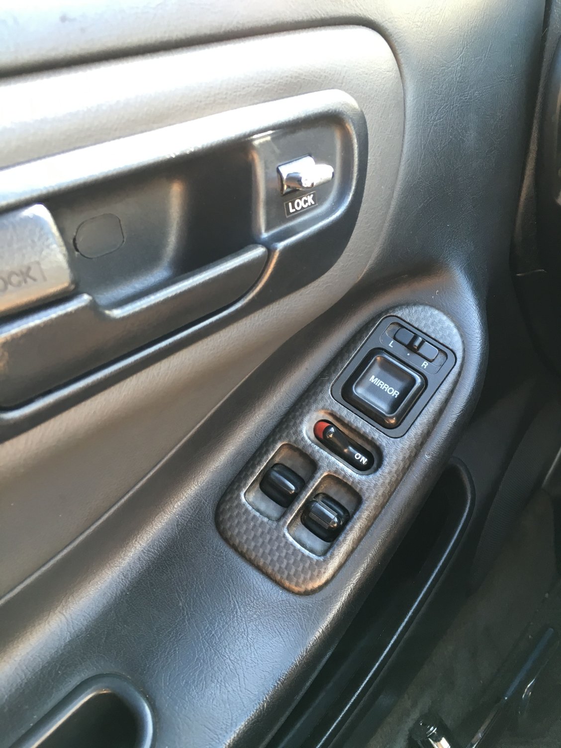

I was able to get the rhd window switches to work with very minor modifications.

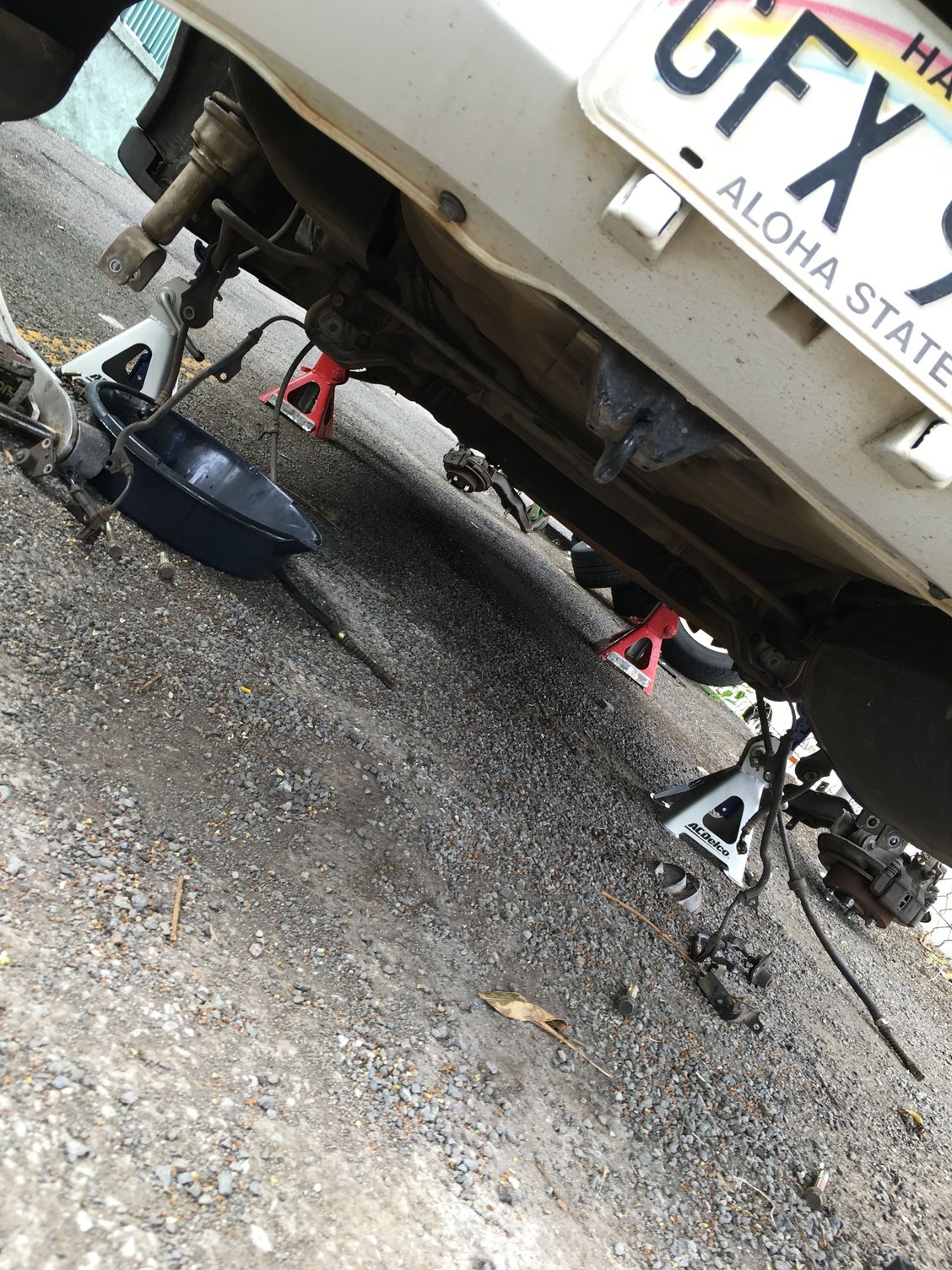

Stock ITR springs on Koni yellows. Loved the ride on my civic so I decided to do it all over again with this car. Once again I love the ride.
While I was at it I upgraded the front brakes to 98+ itr spec with itr caliper & bracket and 11" prelude vtec rotors (this was prior to the extended studs)

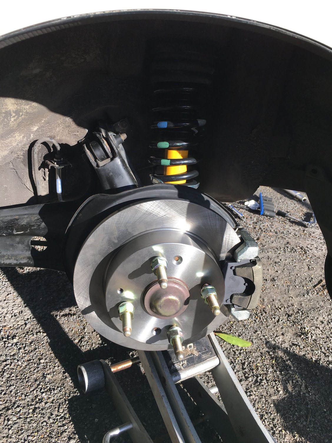

The rears got the same treatment with 10.2" rotors and type r/ ep3 bracket and stock calipers

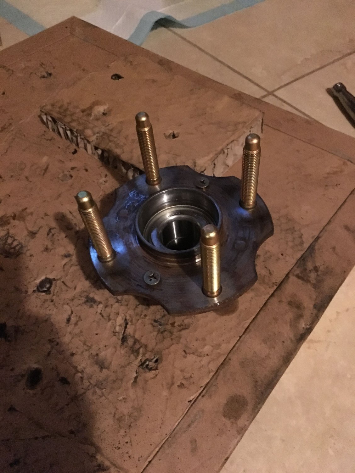

Life hack: using a ball joint press makes easy work of the rear studs
I didn't take any pictures from changing out my front studs but I did it the poor mans way by shaving off part of the base of the stud and part of the hub then pulling them through with a old lug nut.

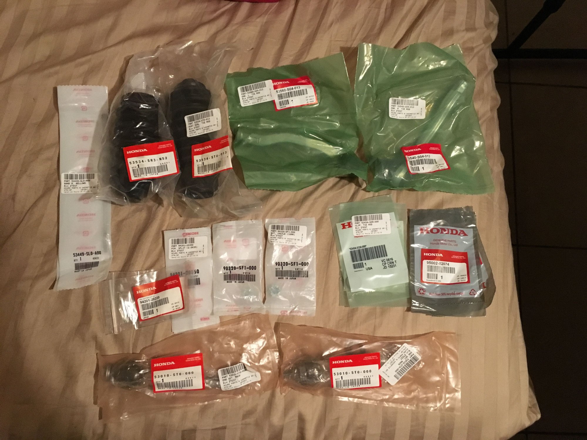

I also changed out the trailing arm bushings since these were toast.
Front hubs and rear trailing arms ready for action. The fronts need a small 3mm spacer so the stock ITR wheels clear the larger brakes

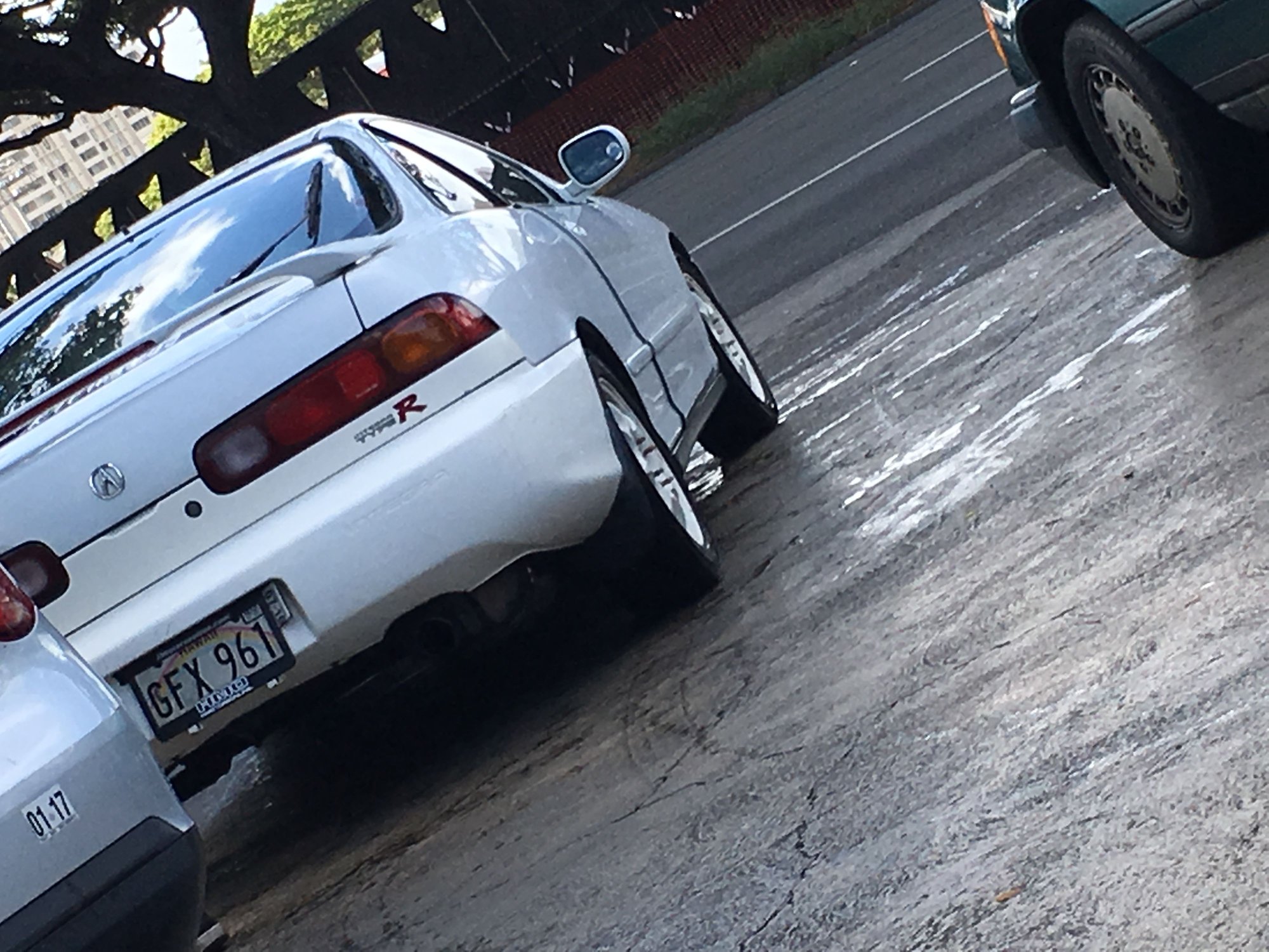

This is how it sits today. I know most of you will say it needs more low but I like the stance. Well the rear could go a little lower but it's fine with me until I move back to the big island because Oahu roads suck badly!

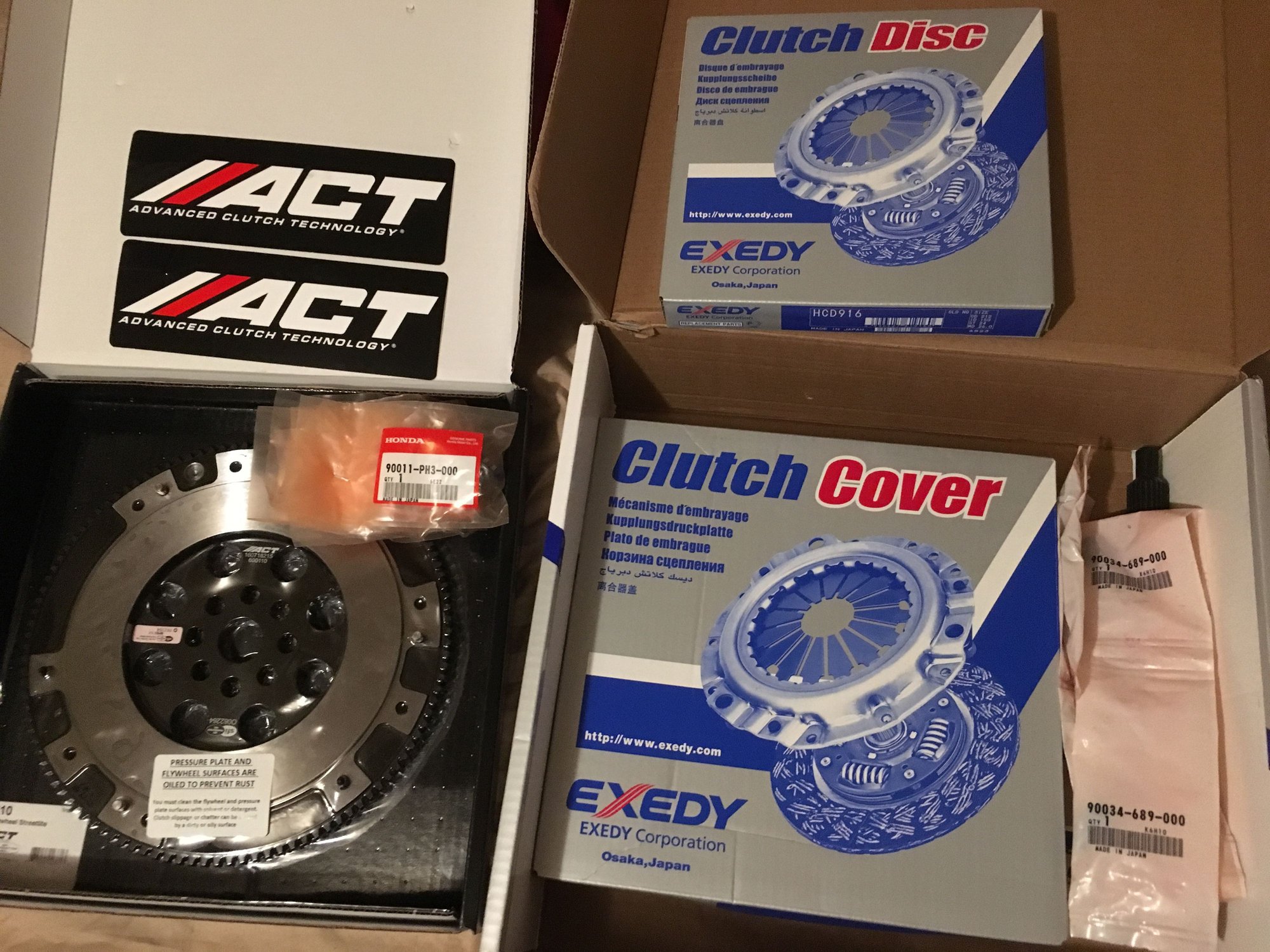

So I got my big box of joy today!
And it was a big box lol. It barely fit through my front door. I never realized how big the rear bumper was until you see it off the car.

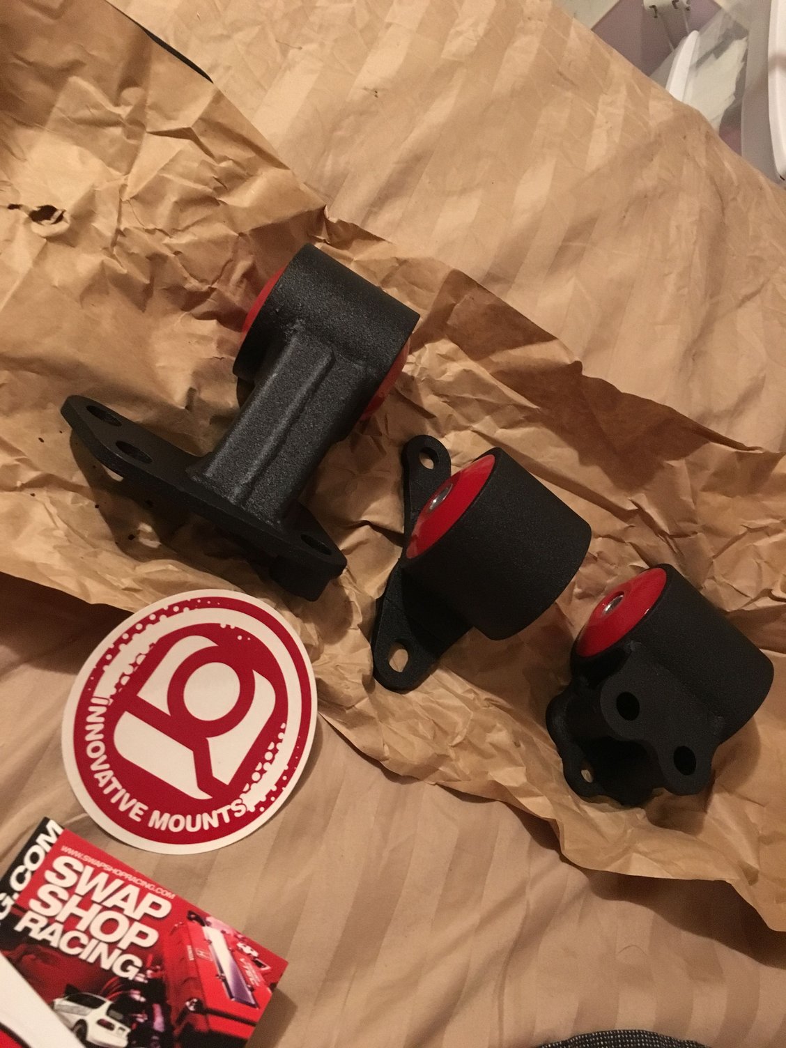

So I got in some 94-97 tail lights in GREAT condition, ITR bumper filler & 94-97 ITR rear bumper in. They were in pretty good condition. Had scratches but no damage so I'm ok with that since the car needs paint anyways. The bad part is I asked for the bumper support as well since mine is f'd up and it didn't come with one and I'm missing the rear top hats that I also ordered. One quick call to Steve and they will be shipped out tomorrow. I didn't get any pictures of the stock parts but I did take these pictures
My first spoon part ever! The best part is I paid for a used strut bar but Steve hooked it up and sent me a BNIB strut bar instead!
Other then the strut bar I've been hoarding these other parts for years. Nothing rare but quality none the less. Oh and in the mugen bag is an authentic mugen poncho!

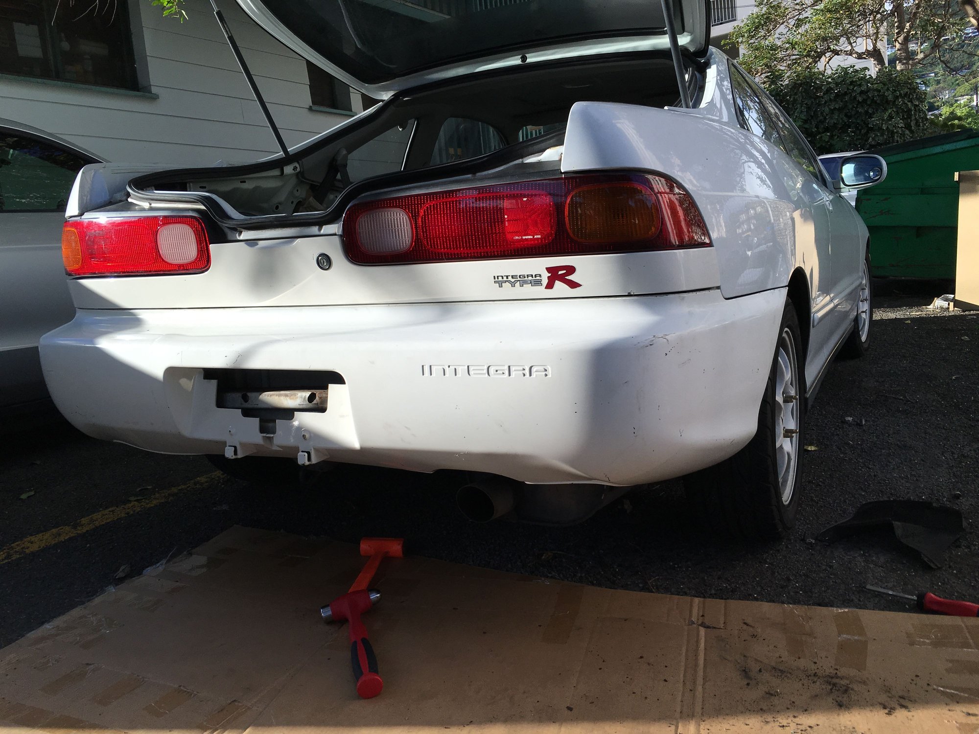

So today I finally got some wrench time in. Last week some of my GFs l family was visiting so I didn't have any time to work on my car. After driving around for 6 months with a smashed rear end (no homo) I finally can drive around in style and non smashedness lol. I'll let the pictures do most of the talking.

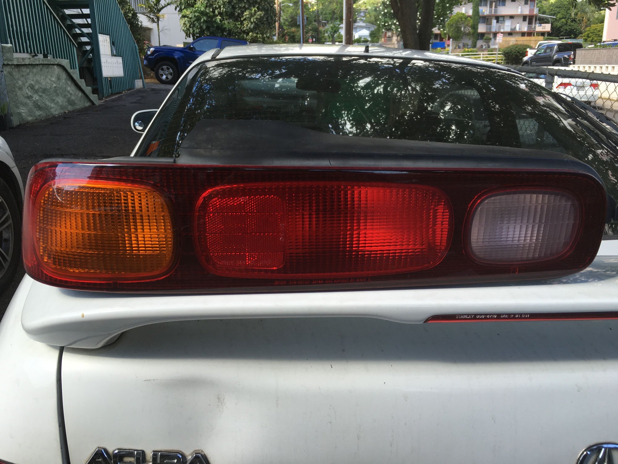

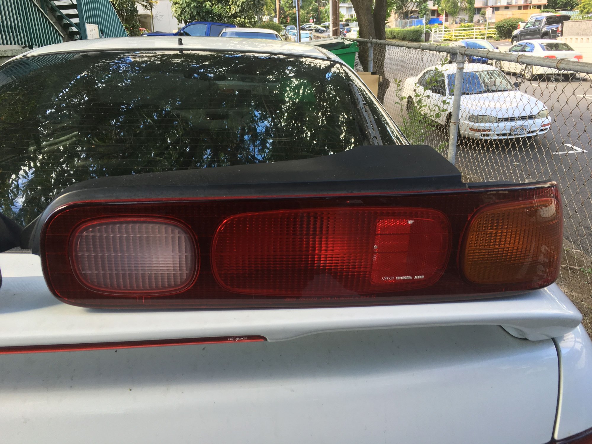

My mint tailights. I'll clean the dried polish from the right side one, one of these days

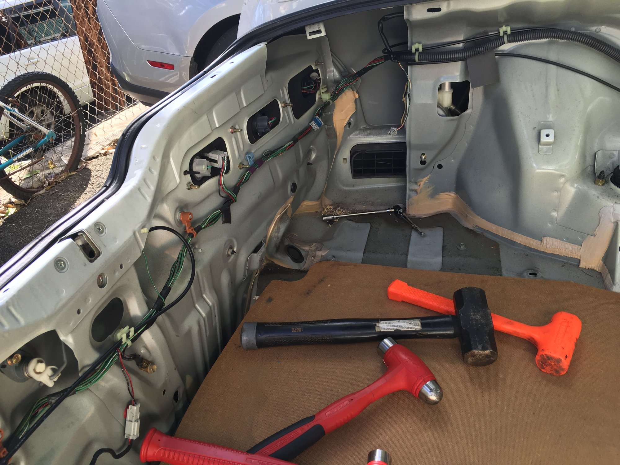

I tried to get angles to show the damage but it is kind of hard to see. It's noticeable in the pictures but was worse looking in person
My girlfriend and our (her) dog decided to check out the damage themselves.
Comparing the straight bumper filler to the Fawked one...
These pictures were to show how much needed to be hammered to get the filler to line up. The tailights were just as bad but I forgot to get pictures of the before and after.
The trash pile. Notice the stock rear speaker I got rid of lol.
This was when I was mostly done. I got everything to mostly line up but I am waiting on my bumper support to get it perfect. Also it was getting late and I'm sure my neighbors were loving the hammering I was doing to my car.

I had a little bit of time to work on my car today. All I did was raise up the front by about 10mm to give the car a more level stance. It's stockish looking now so I won't get into trouble with the fuzz or when I get my safety check. I've been disappointed on how shitty the finish of my refer bushed calipers was. I had them on for not even 2 months and they are starting to rust. Looks like I need some silver VHT soon.

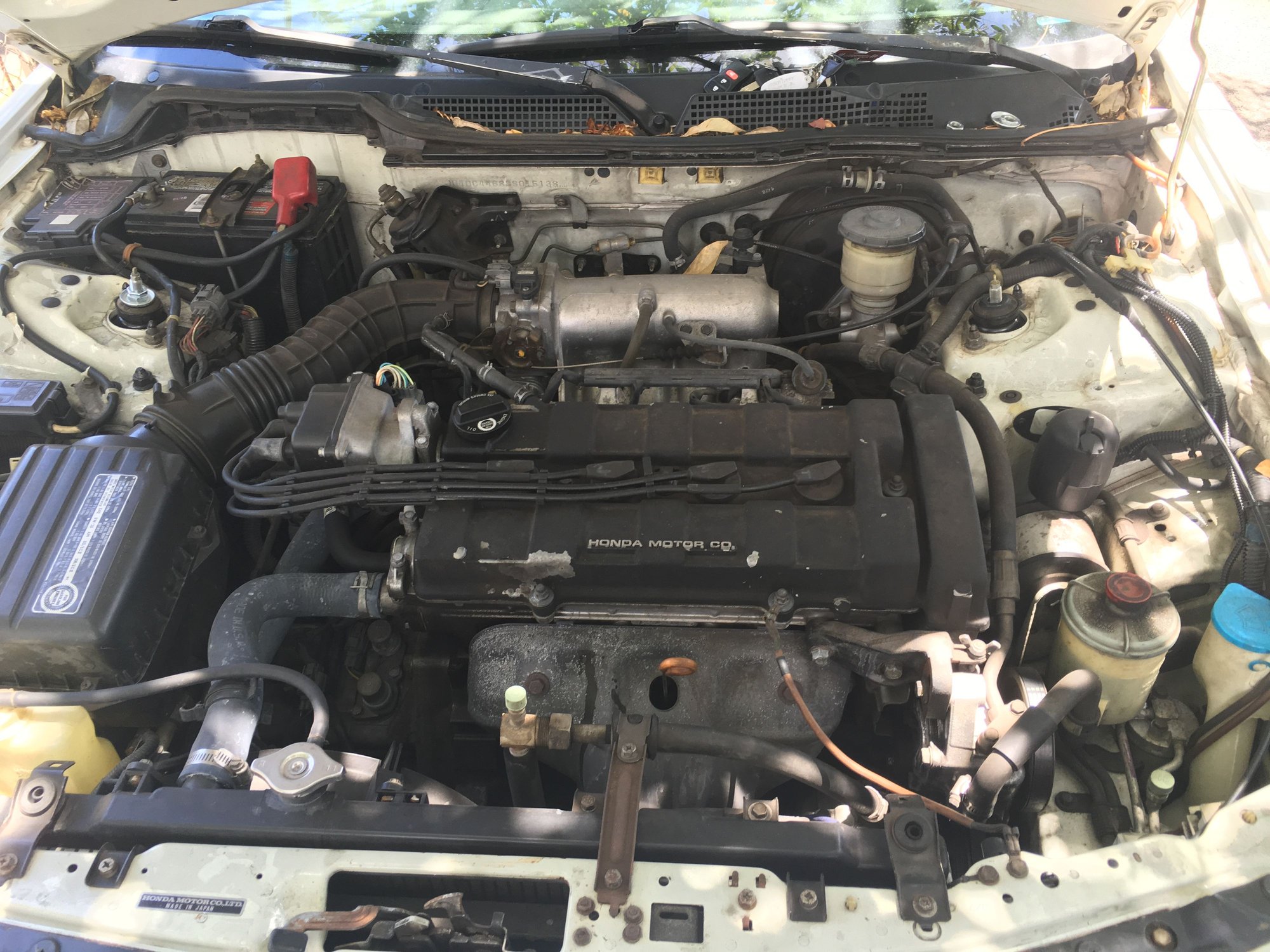

I never took a picture of the engine bay and all of its glorious stockness. It's dirty but I'll take care of that eventually.
I also need to checkout the pads since they don't seem to be making full contact on the drivers side.
This is to show the difference between the piece that comes with the konis vs the spacer one to raise it 10mm. It's good quality for the price and came from Canada.
I didn't take much pictures of the work being done but I did snap pics of the car wash after that. I'm a lazy guys sometimes so I let them do all the work lol
I really liked this picture I got before they finished drying my girl.
Lastly the final ride height. Suspension wise nothing will change until I move back to the big island and decide which swap to go with so I can choose spring rates accordingly. Also Oahu roads suck.

To anyone who actually was keeping up with my build I finally did some work on it. I changed out the inner and outer tie rod ends with oem units. The old ones were well used and making noise every time I went over a bump. One day I'll change out all the bushings and my suspension will be better then when it was new.
Now onto the better news, one of my friends decided to swap out his b16 trans on his b20 vtec to a gsr so I picked up that from him (no pictures)
I did however get a oem replacement clutch, act 12 lbs flywheel, the oem flywheel and pressure plate bolts and innovative steel mounts
one of my friends works at a junkyard and is getting me the rest of the swap parts that I need. After this my car won't see any power upgrades until I do a j swap next year
