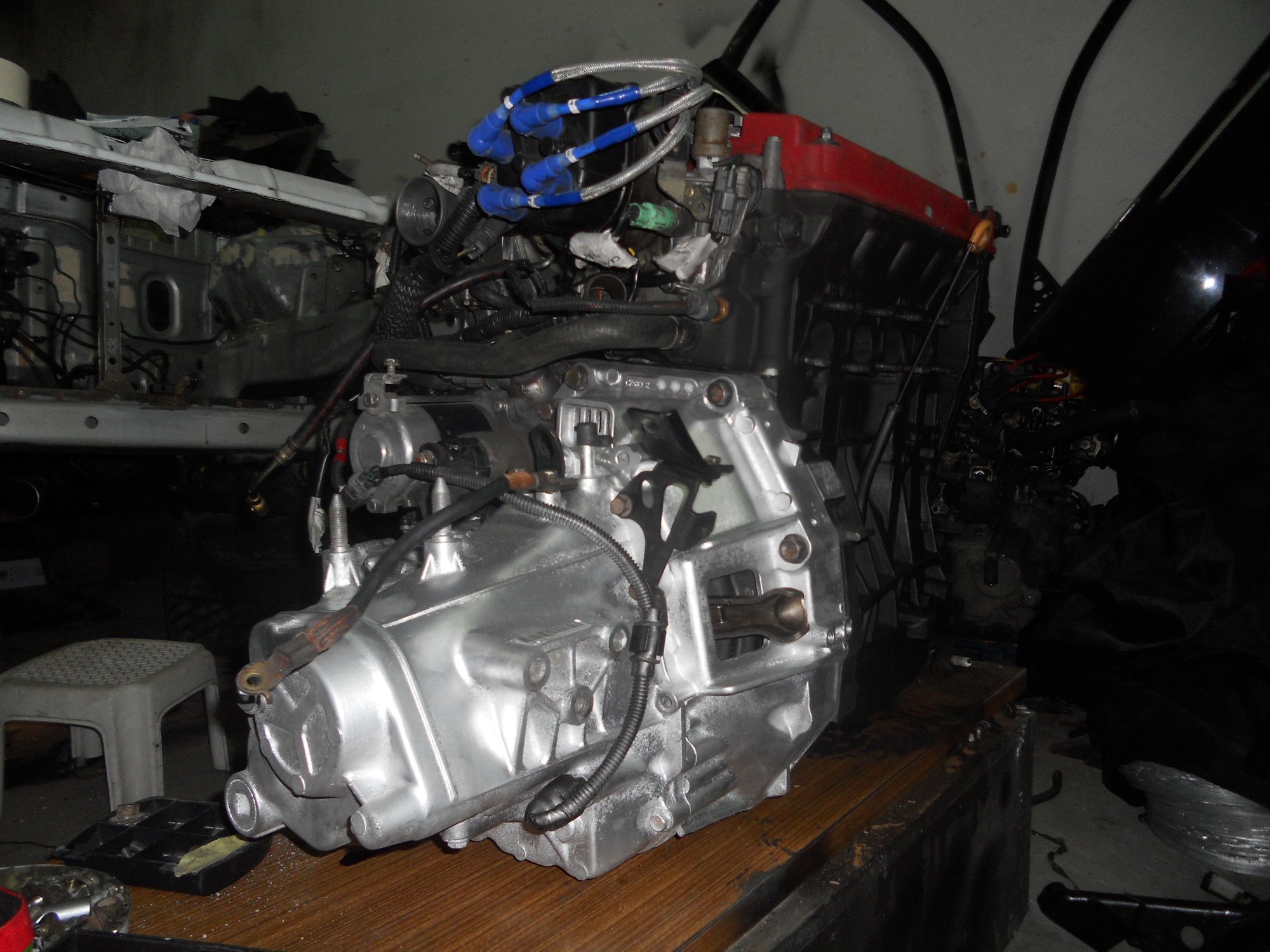

so here she is about to get out.. i have to say i thought alot about doing this as this engine had never been removed before since factory and im pretty sure about that cuz of the service history and i could just tell thats was all OEM.
nearly out
here she is out
As u can see the engine bay is grey.. that was the OEM colour of the car
So now that shes out im gna start .. ABS delete.. and some wire tuck.. and painting the bay white? aswell :Smile:
and as she also needs a new steering rack im gna probly go manual steering rather than this crappy power steering..
but like i say this is a long time project..

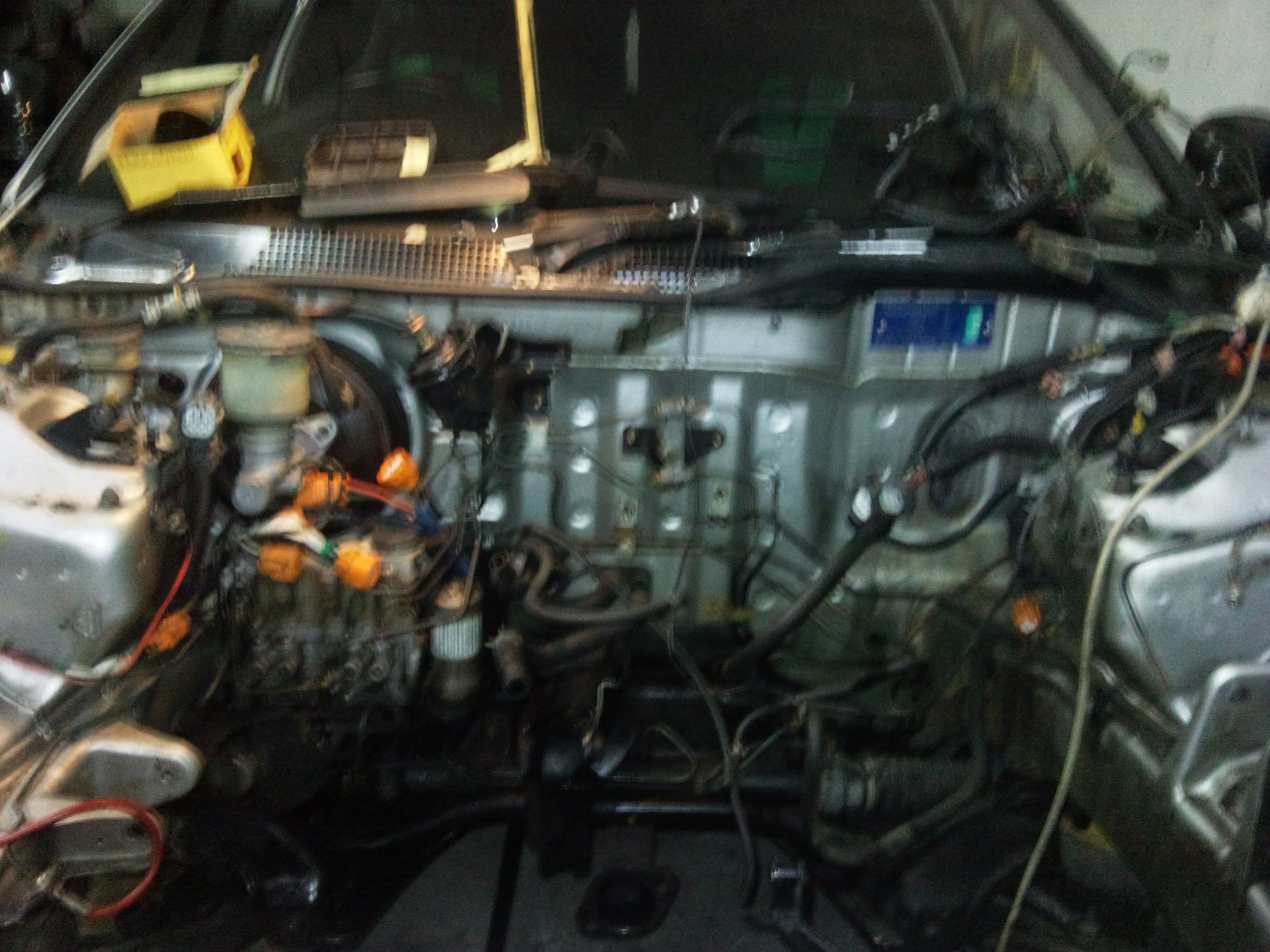

Engine Bay nearly done. tucked alot of wiring,extended the main plugs so they can all connect to engine harness near to the subframe rather than at the top. Still need to relocate alarm siren and some other bits..
Now next step on the engine bay is gettin subframe and that steering rack out. send it to refurbish/reconstruction. So i can convert it to manual steering.
And then i can start with washing,sanding and finally painting..
I managed to get the ABS delete 100%done in the bay . as i was having some issue with 1 brake line.
For Info if anyone needs. I used stock ABS brake lines. And used a 30/30 proportioning valve. out of an EG3. Doesnt look bad.. But im still thinkin about movin it somewhere else..
heres a pic of the prop valve (theres one line missing in the picture)
I also finished the air thingie delete..
Only Thing needed is to Loop the 2 Hoses that comes out the block. to the air system.
Tidier lighter and, nothing behind the dash .. I need a lid for it though ... Any ideas Guyz? i dont wanna solder... nd deffo cant leave it looking like that..
And then finally some pics from the interior.. delete SRS ECU and wiring, And ABS ECU and its full wiring.. Which is still Being tricky, because of wires from ABS joining together wiv the actual cars wiring.. If anyone has done it before let me know PLEASE!..
more specifically
The ABS systems ECU is in the interior at the back on the right side of the car(1st pic below) , and the ABS wiring loom is all those orange plugs.(seen in pics below)
Thing is some of the orange plugs are a contunuity and connect to the actual cars wiring loom.. So.. Can i just cut them all? and then like bend the ends and heat shrinkthem and tape them and hide em away? iv cut a few i had to .
im kinda skeptical bout doin this as im not 100%sure about those wires.. but iv tagged some of em just in case i gotta put them back on lol
Help in this please! I know there are alot of ABS removal threads, but not about Removing the whole thing. ABS pump, fusebox, and complete wiring up to the abs ecu...
Another point guyz, In the pics Above. You can see i have 2 alarm systems still mounted and active in the car.. 1 Honda oem car security. and a viper.
Thing is i bought the viper and asked an electrician to mount it, and they mounted it on top of the oem alarms wiring.
the oem alarm still has its immobilizer/fuel cut working.
if i unplug the old alarm. the fuel relay will not work.. i wont hear it injecting fuel
What can i do to fix this? Id rather take both of them out if needed.
but im not too sure if it is that easy? my viper goes into ecu wiring etc.. they are all together and it just looks so messy ...
I rly dnt wna have all this work and leave those likethat.. Help anyone ?

Updating..
Iv got a couple things done in the meantime..
I got my fusebox inside and the battery aswell happy days
heres some pics
Heres a random pic of what iv got goin on in the garage at the moment
ignore the mess and the writen off 4x4 lool
heres some pics
