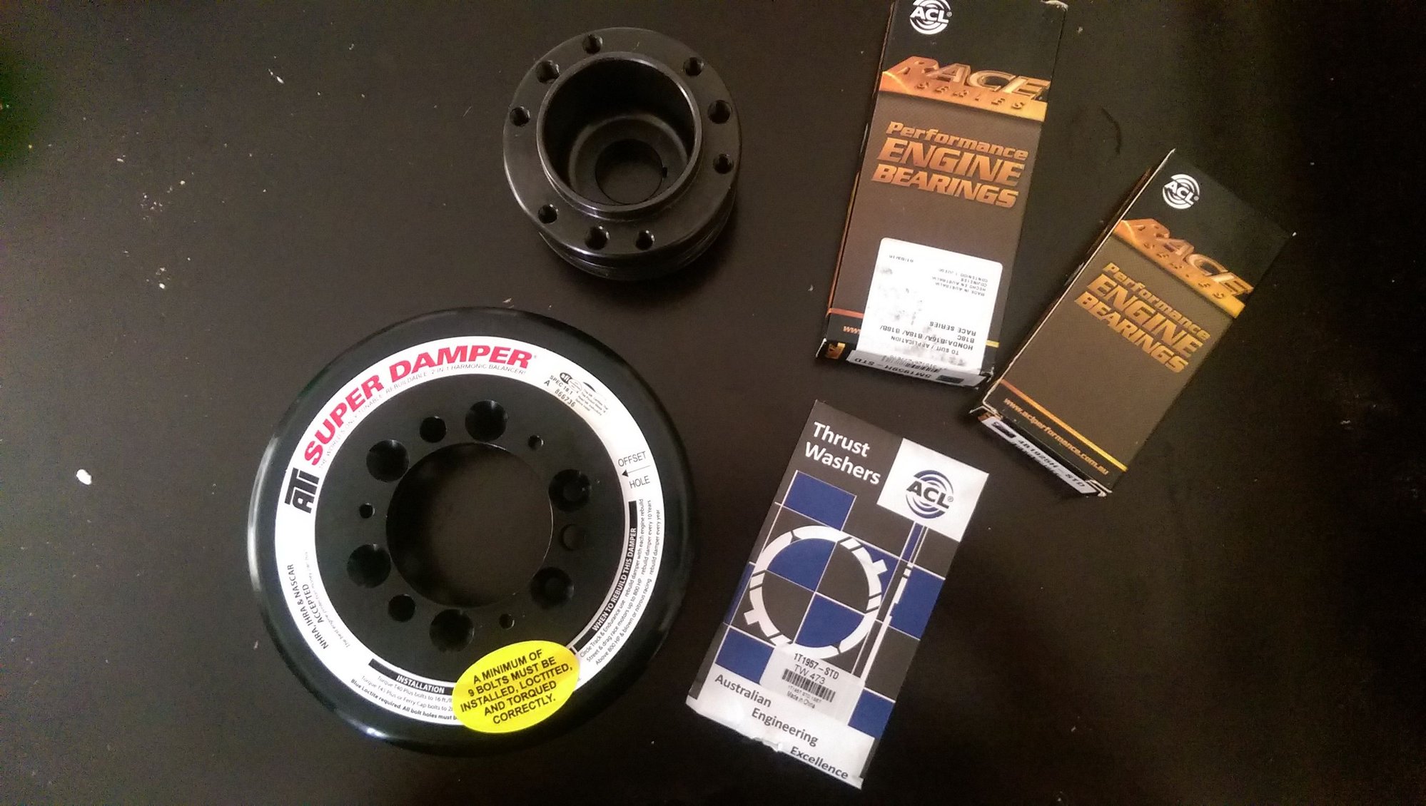

Got some goodies in the mail today...CP Pistons are next...
