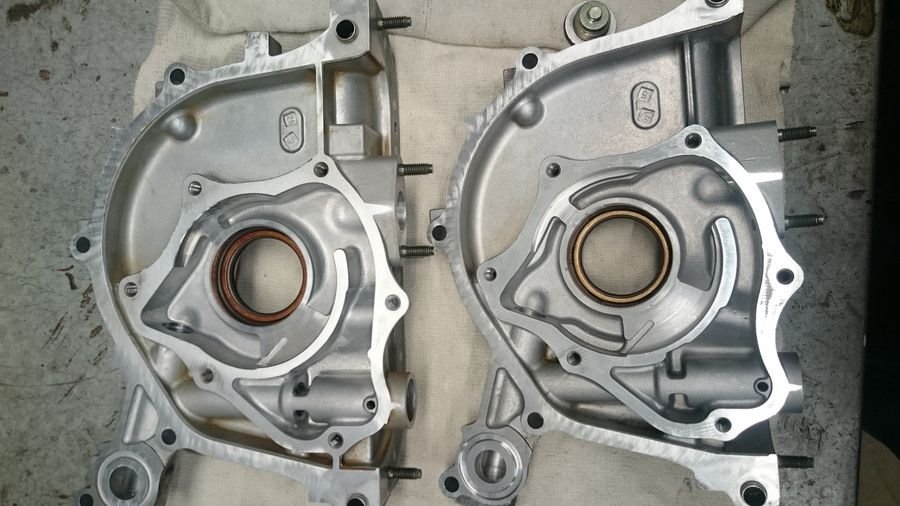

On top (two pumps) are 80mm rotor versions. One from 96-00 B16A2 and genuine spare, "PR4". Below 84mm version from 92-95 B16A. I have also OE-pump from 98-00 B18C6 but not in pics, it is equal to top ones.
So, the differences. Pump gears of course, and 84mm have a little wider inlet channel and outlet's entrance is smoother. But like I said, nothing drastically.
80mm left and 84mm right.
Inlet from 84mm version.
Outlets entrance from 84mm version.

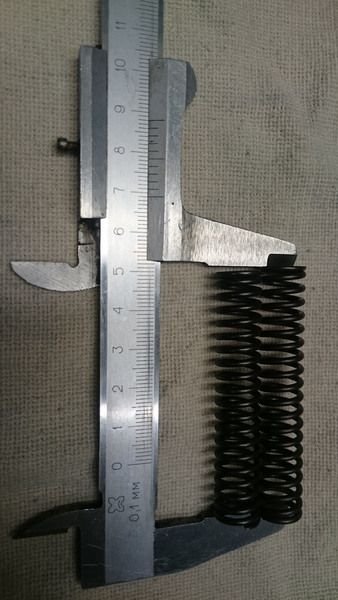

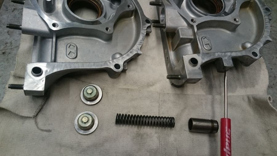

Also, newer pumps (P72, PR4) got stiffer pressure valve spring (69mm) when older one's have a 68mm. Spring wire same 1.9mm.
Btw, this new springs is exactly same as K-series, even same part number (15232-PG6-000).

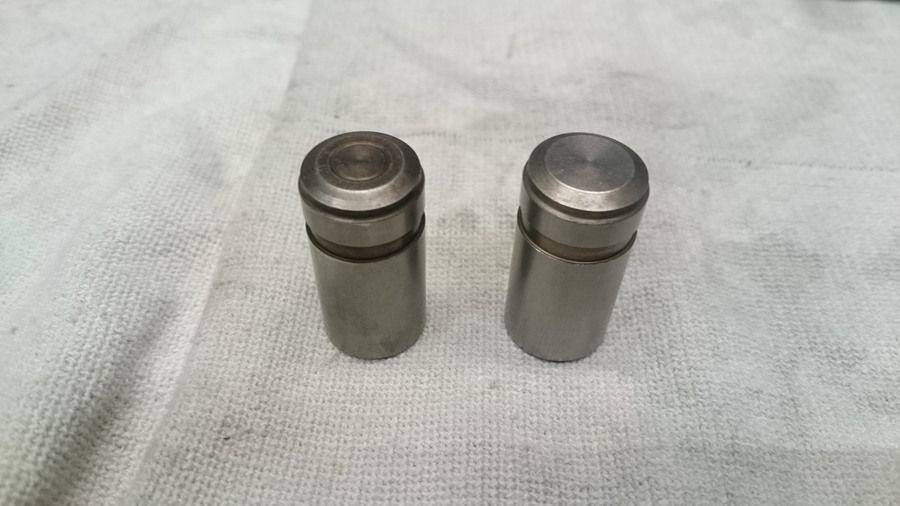

Valve piston desing is same in all pumps.
But there's good details whereof you can identify which one is which, without disassembling whole pump.
80mm pumps has that "square" front of the pump housing (front/ headers side of engine) and 84mm's do not.
Another detail from 80mm's housing.

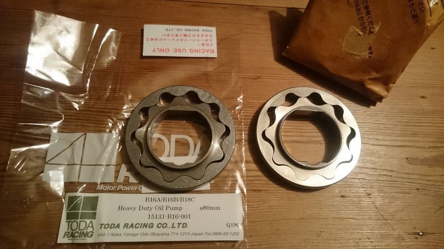

Bonus, Toda HD oil pump gear vs. OEM. Same desing, different material. Toda weight 226g and OE 200g, inner and outer rotors are both ~13g heavier.
