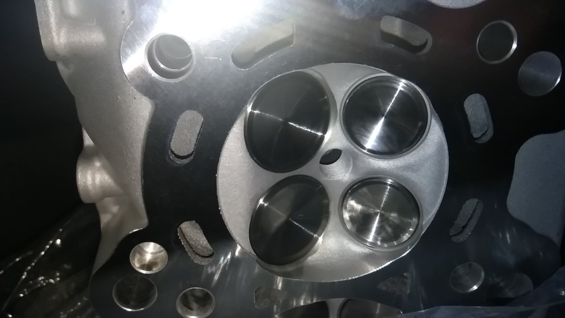

did 4p ever get back with you about the intake ports?
Yes, they said it's normal and something to do with boundary layer of air. Which I don't know anything about but none on their website look unfinished. It doesn't look good but whatever as long as it makes power.

i know the ribbed cnc'ed part is that way for the boundary layer of air, but the parts of the casting that have no machining done to them strikes me as weird. idk, Im not a machinist or anything but ive never seen a ported head look like that.

The uncut parts of the intake ports that you have pictured above is simply from "casting shift" when the head was first cast. Obviously, this isn't as visually appealing as a port that is fully machined... however, it does mean that the specific "un-machined" part of the casting is plenty large. Mine looked very similar to yours with respect to some small un-machined areas... and it made GREAT power.
