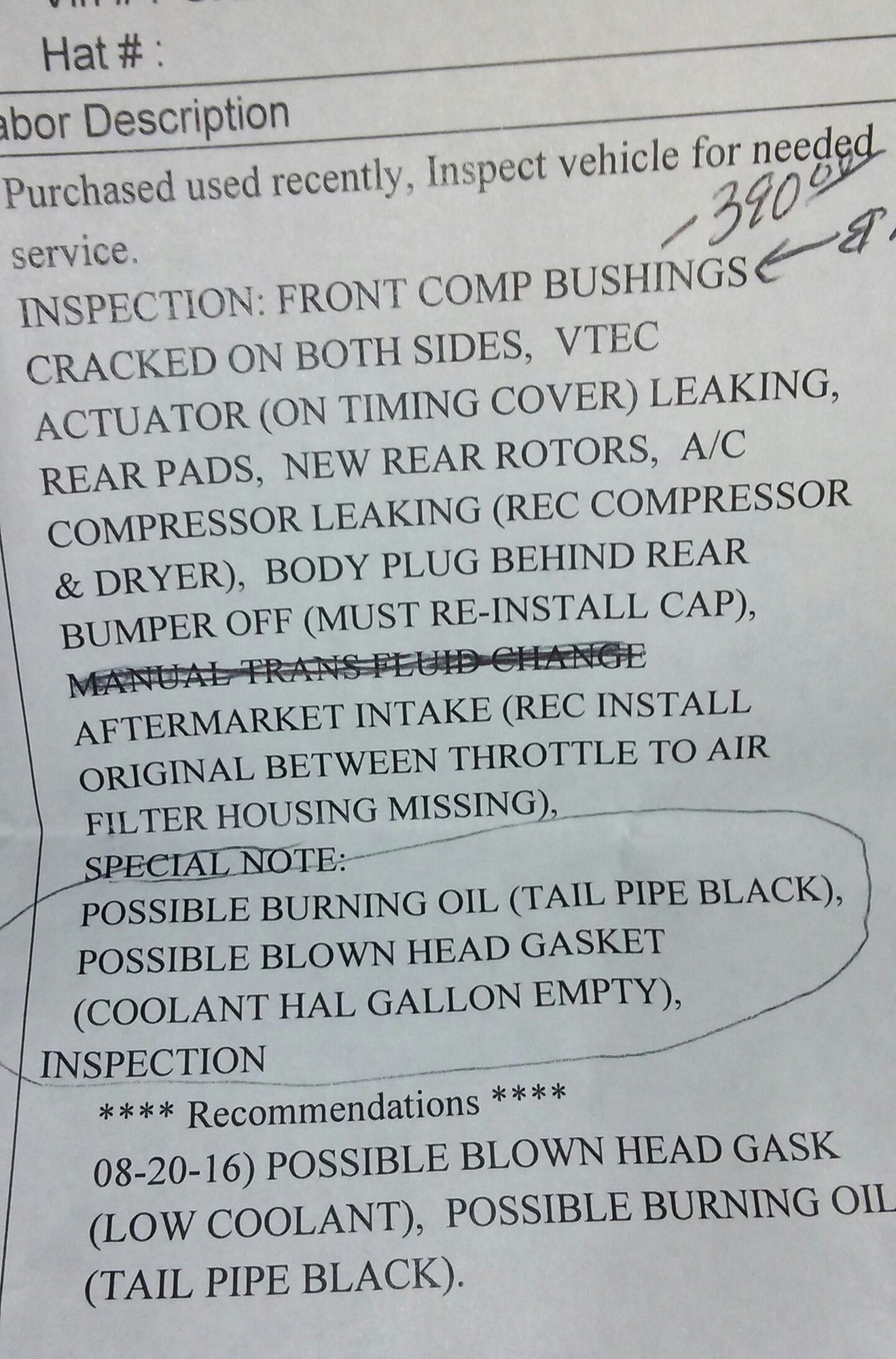

Took my new ep3 to a mechanic.

combustion check, compression check,
Ask mechanic how did he verify a/c leak
How did he verify rear pads and rotors needed to be replaced?
Do you yourself see the vtec actuator leaking? Get some brake cleaner and clean up the engine to verify leaks.
Ignition system might just need some love

When i buy a more valuable car, i spend the $150 for a detailed inspection. Rarely is a used car perfect, so i use the inspection cost as a bargining chip against the purchase, It's always a win win! If the car needs nothing, you are good to good, knowing you have a great car. If it needs a couple things, use it against the car, if is a piece of "you know what", walk away and be glad you don't buy it.
Thant being said, if you have the car now, you have a couple choices:
- resell the car, and get as much for your car back as you can.
- do and engine swap, look for a deal
Just today, i'm actually buying a donar car for extra parts, for my own project, Full running car with 75k for $500
Thanks for the reply. Im not even sure where the vtec actuator actually is.
Im hoping the head gasket is fine..and Im not sure about the odd pulling/tugging im getting while accelerating/decelerating. Maybe the car just needs a tune up.
If the clutch was going bad..wouldn't i only feel it slipping while the clutch is engaged? Or will ot affect the acceleration even after the clutch was disengaged?

When a clutch is disengaged (your foot is pressing the clutch pedal down), the car will not accelerate.

Thanks everyone..I may have been panicking a little bit because this was a big purchase for me.
Im not getting any typical signs of a blown head gasket- white smoke from exhaust, milky oil etc.
Hopefully the coolant was low for some other reason and will keep an eye on its level. I will also check my oil frequently.
I do think the compliance bushings are bad however, because of how thw car handles and the front buckling noises im hearing.
I do plan on changing out thw spark plugs myself and hopefully will help with the tugging of the engine.

Sounds like the hesitation needs to be addressed ASAP. You can easily cause more damage if you ignore it and keep driving the car.

Just by reading the recommendations, I'd say it's probably time for a new mechanic.

Why is that?

If he diagnoses a blown head gasket by checking to see if the coolant is low then he might not know what he is doing. If he thinks there is a blown head gasket and he charges you for this diagnoses you just had then he should have down compression test and/or a hydrocarbon test. If the coolant is low and he thinks that means the head gasket is bad there is a tester that checks to see if there is hydrocarbons in the coolant to see if the head gasket is in fact leaking. Instead he puts down that the head gasket is possibly bad causing you undue stress worrying whether or not the motor needs replacement. As someone said earlier a compression test and/or leakdown would be a great place to start. The hydrocarbon test wouldn't be bad either >>> https://www.amazon.com/Lisle-75500-C.../dp/B0007ZDRUI . I don't know if that would be my first check though he could pressurize your coolant system and see if there is leaks for starters.
I know if this was me, I would look around for a Honda specialist and take my car there for a new diagnoses. The guy that you took this too seems to be going worst case scenario on all his diagnoses and he may have given you more information on each item when you picked the car that you haven't told us about but it seems like he trying to get a trip to Hawaii out of you.

Low coolant - Says head gasket
A/C leaks - I would get a second opinion. Compressor can leak, but more often than not it's a $1.00 O-Ring at fault.
Black tail pipe - Must mean it's burning oil, right? Cause no other possibility exists?
This guy reminds me of those tire places (Les Schwab, Big O, etc.) that recommend replacing brakes/calipers/rotors every time they see a rotor damaged.
If a rotor is damaged, you should definitely replace it.

Okay. I went to get the car smogged and it passed.
After that I drove to a small shop a few cities over and the owner checked my car out for free.
He simply poured my coolant into my car while it was idling..and the radiator started bubbling like lava. He said the head gasket is blown because of this.
Im going to order one of those kits that test for exhaust in the coolant just to be sure.

Ummm...your coolant bubbling didnt' cause the headgasket issue. The headgasket issue is causing your coolant to bubble. But yes it needs to have the head checked for warpage and the short block as well. Might as well get the valve stem seals replaced and the valves clean and lapped.
