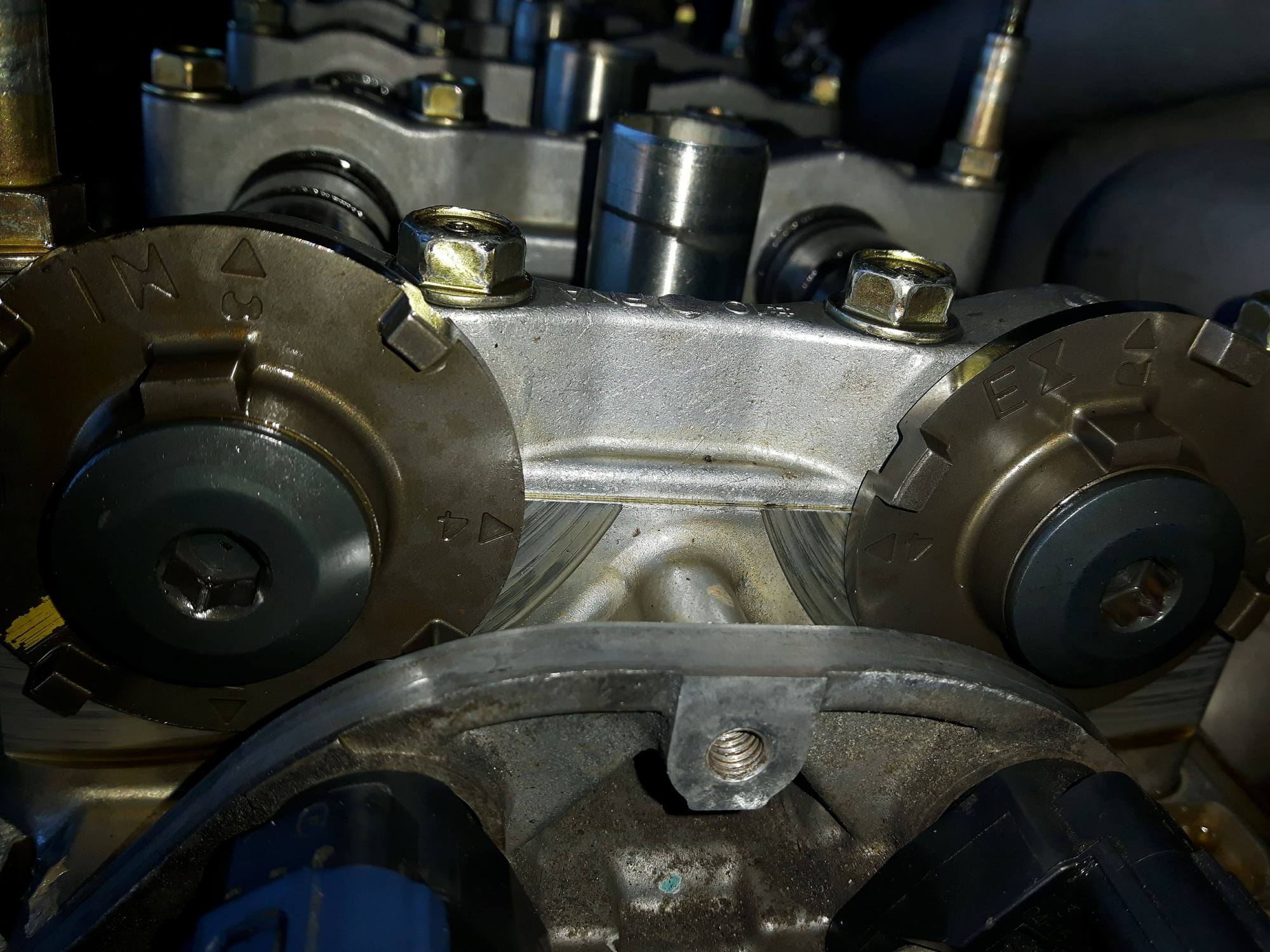

I need help please (Rsx type-s k20a2), my car start well and idle well but keep shutting off every 2-3second everytime I start it?Hes throwing 0 code, The problem started when I reinstalled my OEM Camshaft. The timing look good but the exhaust Cam pulse plate hole doesnt match I dont know if thats a problem (you can see it on the last picture), but when im giving gas on idle the Cam angle read -3degrees on kpro its clearly not normal, someone have an idea?

theres a "cam tool" to align those holes up. sounds like the timing is off from what you're describing
