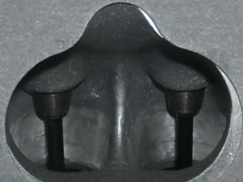

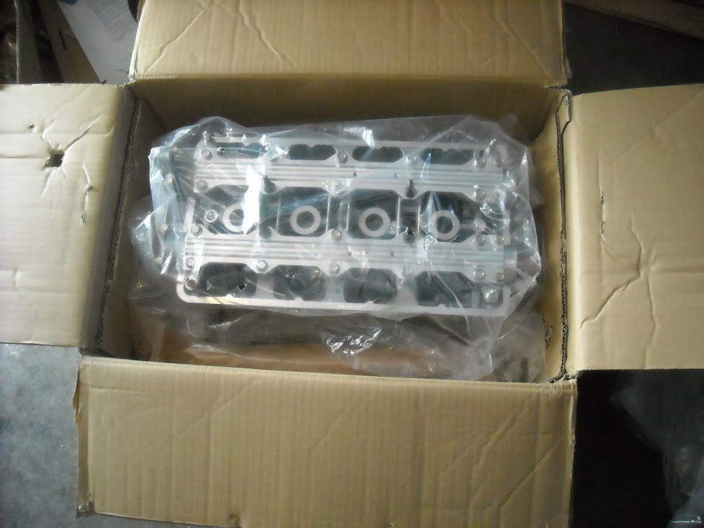

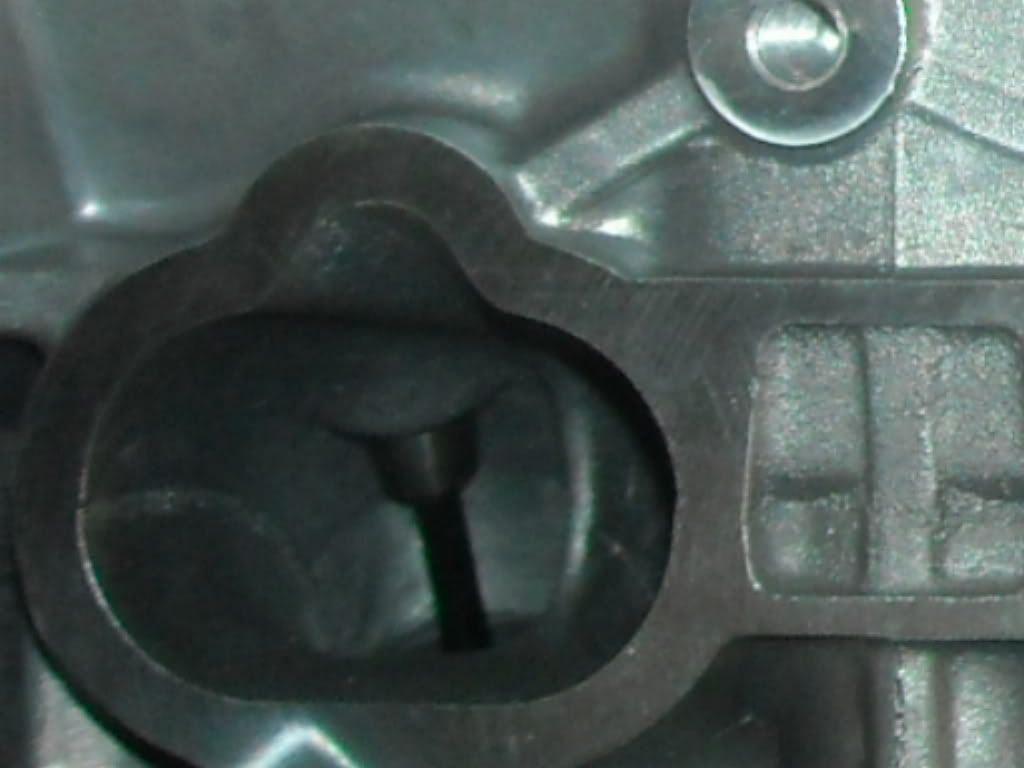

This is a old thread but for anyone who wants to see the port work here is a pic from my build thread of my brand new out the box Type R head. It is stamped pr3-4 by the way. Note only the Intake bowls are swirl ported, very mild work.
