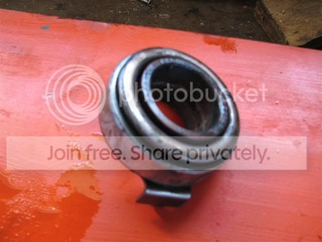

The bearing you are referring to, is it this one?
that bearing is okay. I don't hear any sounds when I spin the final drive and the bearings on both sides looks good. They don't feel tight, but with housing mounted it should be more "locked" right?
What about the diff. then? is it possible that something is broken inside? When I spin the diff I hear a little bit of mechanical sounds, but I'm thinking that it is only normal. Can't hear anything that sounds like the rattling sound I get when driving so.

hmm worn bearings usually just make a wurring noise unless they are REALLY poked.
About your CV bearings, those little inside circles aren't supposed to come out. Did they just fall out or did u pull em out.
Maybe the inner CV bearings are your prob. CHeck how much movement they have and how smooth they are
