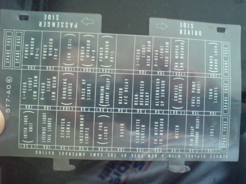

Well it just won't start...
It had half a tank of gas, so I filled up the rest of the way with 93 octane and sta-bil.
I changed oil and cranked it over slowly a few times with the dead end plug for the injectors removed.
I swear I don't hear the fuel pump priming at all... Maybe it just died from sitting?
I'm going to check the fuses - but I misplaced my cabin fuse cover and don't know which is which - anybody got a pic of the little label sheet on the inside of the cabin fuse cover for a 2001 itr?
I'm going to pull the plugs, check and replace them too.
If worst comes to worst, I'll drain and refill the gas tank...

Wunfstgsr, thank you so much!
Yes it's cranking and not firing!
I checked fuses but didn't see any blown - well I blew one trying to jump it with a jump box, and that threw an ecu code, so I replaced that fuse - I think it was 15amp, and also replaced the battery.
Now it's cranking but not firing.
I noticed the fuel gauge is directly on the E, and it should have at least half a tank - although I think it's full of gas.
I'm going to double check all fuses and relays.

You blew a fuse trying to jump it? Did you accidentally put the jumper cables on backwards? You may have blown more than just the fuse...

I checked all the fuses and only the fuel pump fuse was blown.
I'm thinking maybe the voltage spike killed the main relay or something because the fuel pump isn't running at all.
I'm going to troubleshoot it more here in a bit.
