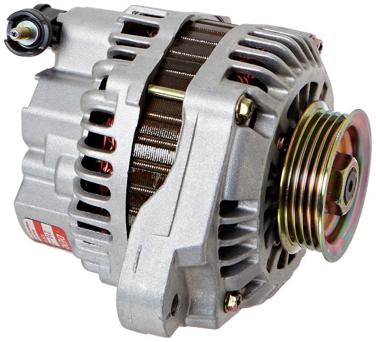

From all the pictures I've seen and other bits of information on the internet, in addition to the pulley being different it also seems that the shaft is different between ITR (Mitsu) and on-ITR alternators (Denso) as well as the placement of the main power terminal. Thanks guys!
(Pics for reference: #1 Mitsu and #2 Denso. Notice the placement of the main power terminal)

OEM ITR in Japan had a Denso.
OEM ITR in US had a MItsubishi.
Both produced less amps than the regular Integra unit (85amps vs 90amps).
BTW: You can also get an OEM P73 Mitsubishi unit re-manufactured by Denso if you want. Denso Part# 210-4190
