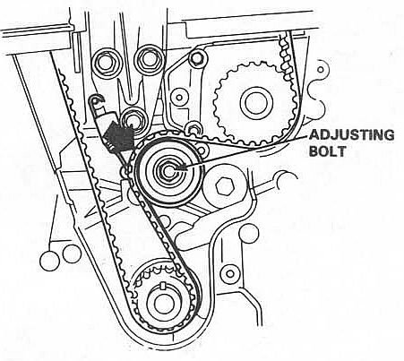

I am looking for the same spec but for an Acura Integra 2nd Gen. It does not have a hex head bolt but a 8 mm socket bolt. So you need an allen wrench to remove it. Does anyone have torque specs or a link for specs?

If your talking about the idle tensioner for the timing pulley it's 40lbs, on all b series from what I've read but here is a couple pics from the motor manual good luck buddy
