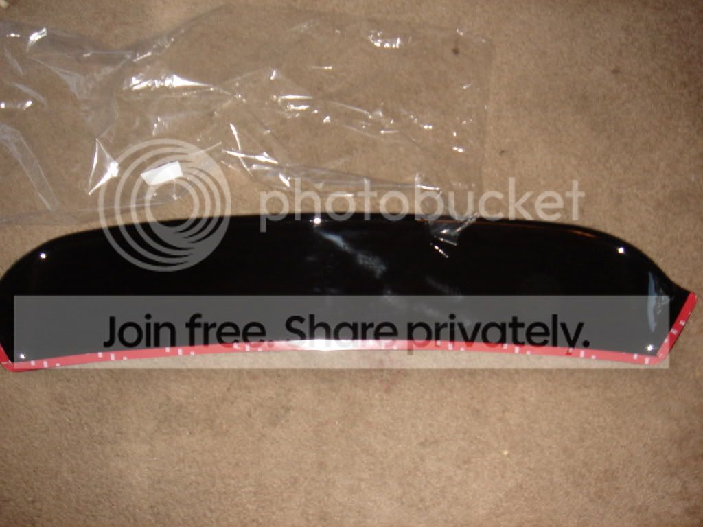

i have a rear visor for my integra, should i add other adhesives to the rear visor? it already has 3m double sided tape on it.
trying to see what other members used or added i don't want it to fly off on the freeway

is it the heavy super duty one? the grey dark colored one, if so then it should be fine if you cleaned it right and did it right the first time. It failed on me the first time so i made my own bracket to put in the middle i'll show you if you need help just pm me!

I have the dark grey 3m tape that came in red film. Its heavy duty stuff. As long as its prepped right it wont come off. Mine has been on for a year already no issues.

It's the same 3M tape that OEM accessory visors come with. Clean the area well with like isopropanol. Mount the visor.
Instructions for OEM visors say to heat the tape area after you mount it.

You can just do it on a warm sunny day.. mid afternoon after the car has been out in the sun all day clean the area off with soapy water.. dry .. clean with a 70% rubbing alcohol and be sure not to touch the tape. Goodluck!

Use a hair dryer or heat gun to gently heat the mounting surface and the exposed tape. That makes it still like CRAZY!
