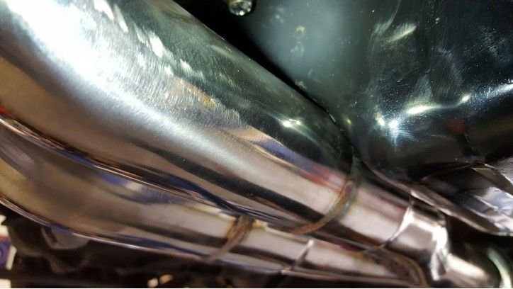

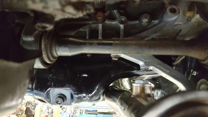

Re: Integra Oil Pan Header Clearance
These photos show what I'm running up against ... literally.
When trying to seat the upper flange of the header on the exhaust bolts from the head (unseen), the runs are pushed into the oil pan, preventing them from mounting up. It may not look like a big deal in the photos, but it's enough to prevent installation.

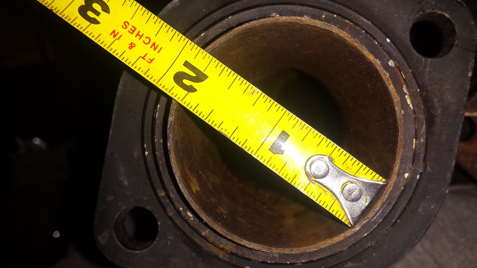

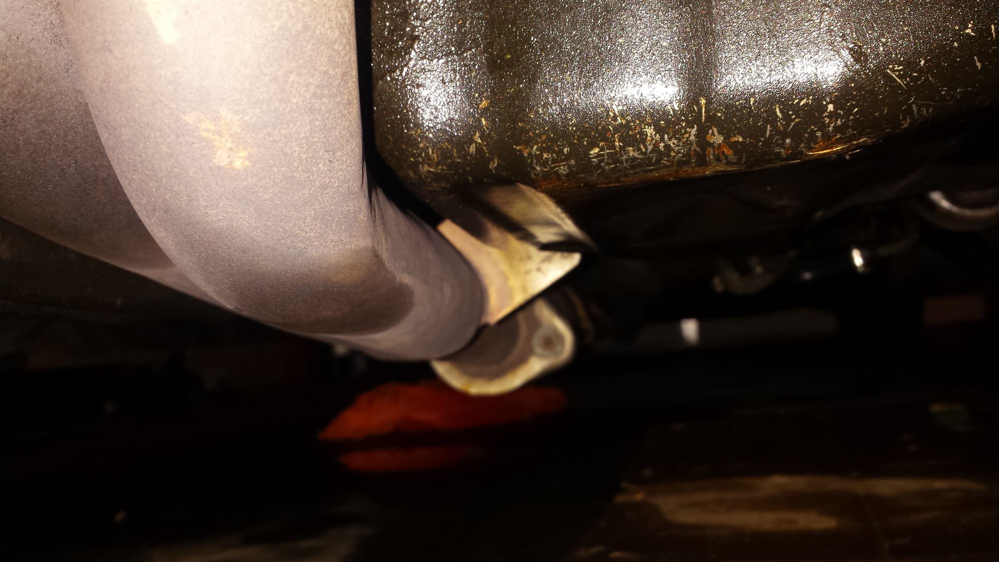

So, I was thinking, and realized when I installed my exhaust, I got creative. I actually took 3, yes 3 gaskets and used some 650 temp silicone and a bit of aluminum tape to make one thick gasket. There are aftermarket gaskets, that are a bit thicker and less likely to blow out. When I used just one, the gasket blew after less than a year. The gasket I fabricated, is still working great!
You can see where i flattened the pipe a bit by the oil pan
3 gaskets, taped and siliconed. It may be a bit ghetto, but it's fully functional!
Thank you for the suggestion ... however your approach will not work for my headers. The Skunk2 Alpha Series are a 1-piece assembly with the only gasket location on the head itself.

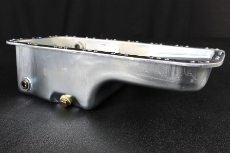

I think that I have a solution though, and that is to swap my oil pan for the Moroso 4-Quart pan. It's claim to fame is that it will accommodate most after market headers, and from what I can see from their pics, the pan bends up closer to the drain plug than the stock OEM Honda pan, and has a more vertical lift there as well. That is where my fitment has its issue. So as soon as I can swap pans (a friend of mine has a lift, but is away on vacation) I'll get back and tell my results.
