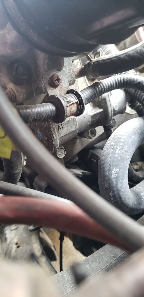

On obd 0 and 1 models the iacv is directly under the throttle top pic iacv, bottom EIC
Iacv
Electric idle control
trm4life is offline
