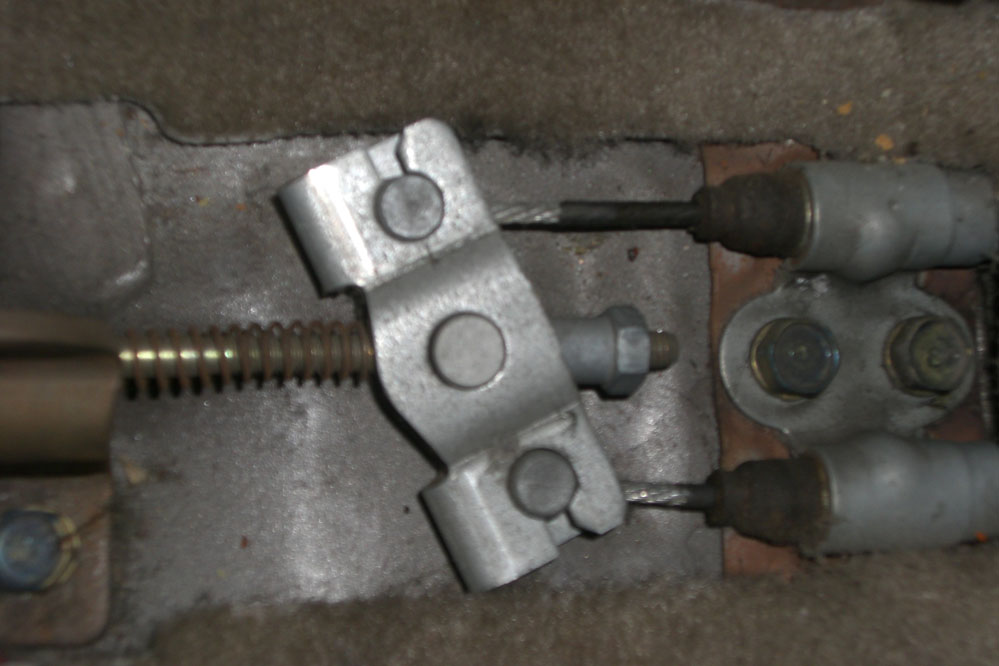

i am enjoying learning how to drive 5 speed. i had a little trouble initially with no parking brake. i took out the console to tighten the adjuster nut and saw this:
i tightened up the adjuster about 10 turns and now i have a little bit of a parking brake. some of the pads are squealing, but i am not sure which ones. from the outside, both the rears look okay. i am not sure what to make of the uneven cables, but i am sure the balancer exists for this exact reason.

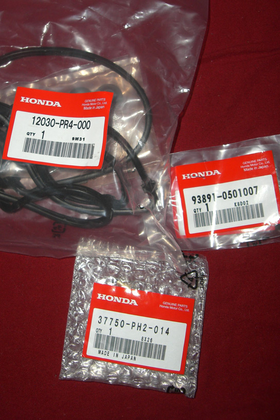

got some parts, today:
valve cover gasket kit
ect gauge sending unit
couple of screws for my steering column shroud
i put the temperature sending unit in about 15 minutes ago. i came in to let my hands warm up before i go out and make sure the temp gauge is working. it's 20* F, right now.

my parking brake looked like that on my ef with da rear discs, turns out one of the calipers was seized up. i'd check that out if i were you

my temperature gauge works after replacing the ECT sending unit. it confirms my suspicion: the car isn't warming up properly.
i let the devil idle for about 10 minutes with no radiator cap. the coolant loss while replacing the little sensor was minimal, but i wanted to see if i needed to top it off anyways. it bubbled a few times, and the gauge started to creep upwards. on my way to work, however, the car wouldn't reach the same temperature that it did at idle.
