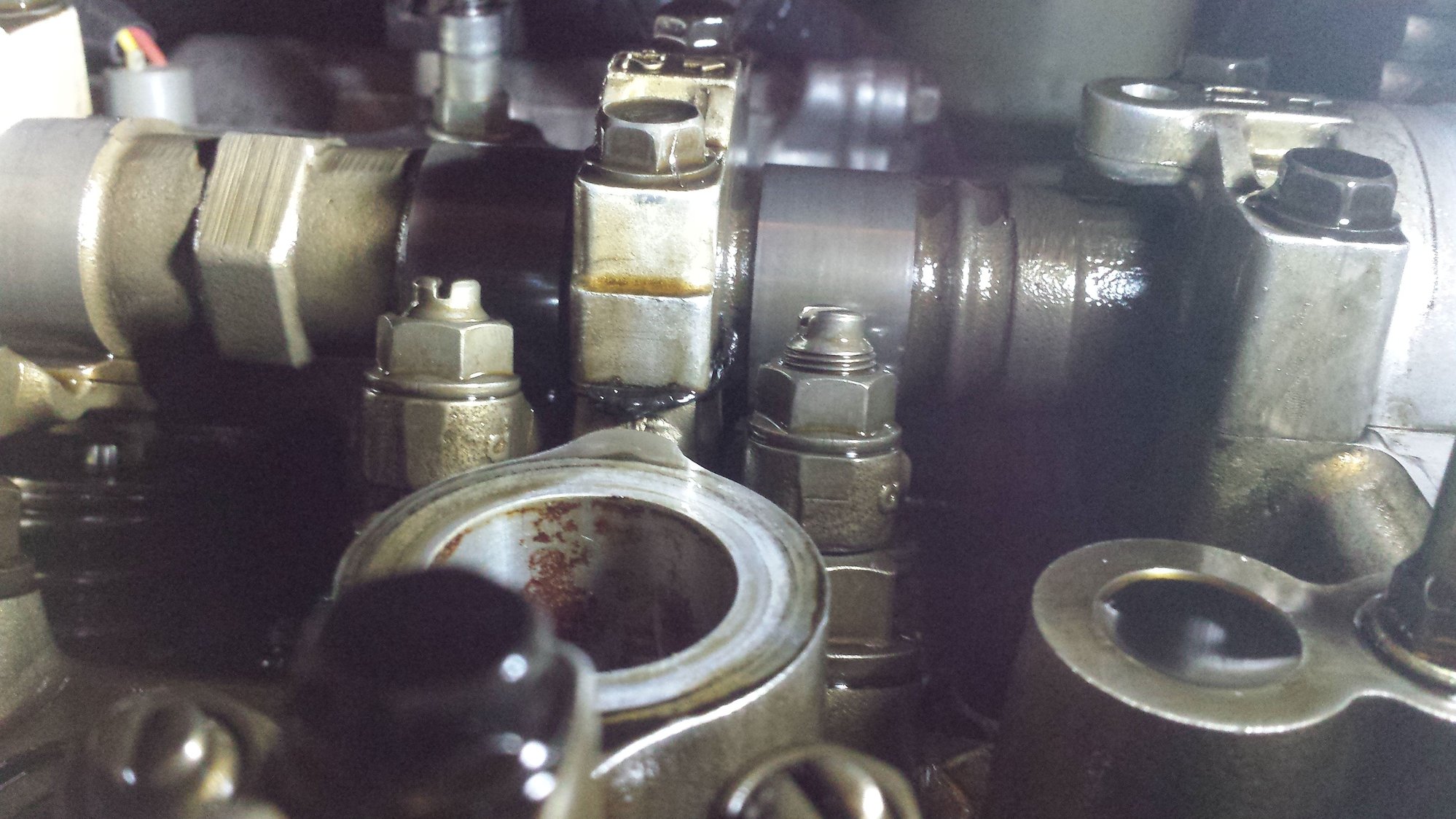

so I decided to tear into my engine, and it appears as though I may not have needed to. I had to remove the belts, break the crank pulley loose, and remove the timing belt, intake cam gear and cam. I was simply reading how to remove the lifter, and it involved removing the cams. No big deal, I've done it before. Well after seeing the rocker simply lifts out, I realized I may have only had to adjust the lock nut. I'm really not sure what the reason was for the rocker adjusting itself. I'm partially concerned it may be an oil issue where I have a clogged oil port somewhere. So, should I just try to adjust the rocker and put it back together? Or am I better off pulling the lifter (also referred to as a "hydraulic tappet")? I suppose checking the lifter since I'm already in the engine, is the smart thing to do. ..

I reused my spark plug seals, so I added some black silicone. Tomorrow after it cures, I'll start up the car and let you guys know how things went. If you zoom in to the ball part of the rocker, you'll see a groove caused from the screw turning while the car was running. Decided it wasn't significant enough to try to sand or grind it smooth.
