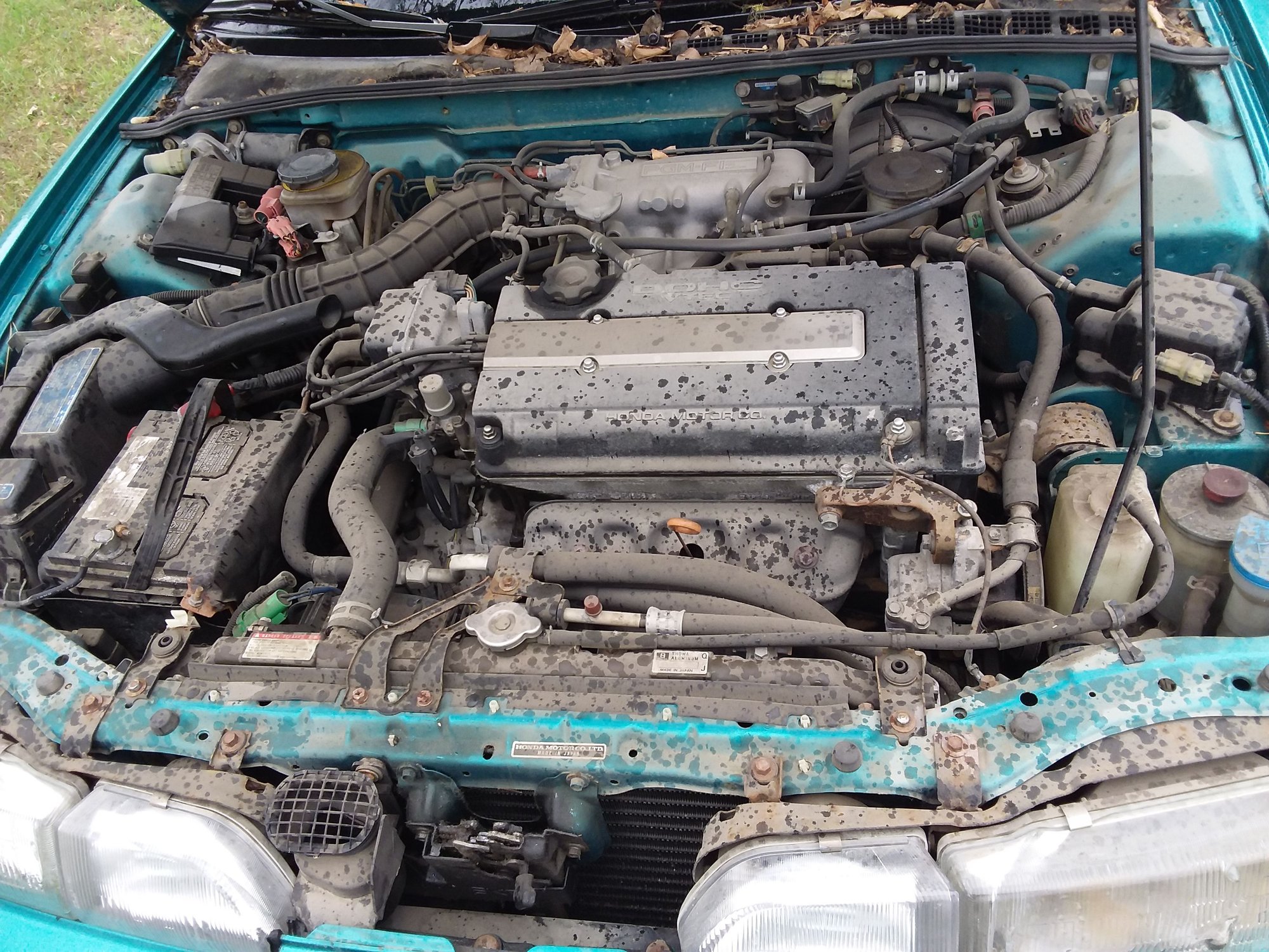

So, as far as "build" goes, I still have to make a plan for 'er.
Off the top of my head, I think I'll fix 'er up to drive on the street and once she is ready the rally hatch will get pulled off and torn apart for race prep.
First step, we have to get it running. The master fuse was blown but still wouldn't start with a new one, it turned over of course tho..
So, I figure the fuel is gross (we have e10 here everywhere and it was stored without a fuel stabiliser).. there is about 1/2 a tank I'll have to drain.
Got new NGK wires I gotta pick up from parts store for her, I got them for my hatch (same motor) but the hatch is going COP in the next few weeks once my Xtra board comes in from the HondaRulez guy.
Oil looked good, didn't check coolant or anything. Will go back tomorrow and try and get it started with some new gas and such.

So I went today to try and get 'er running. Thought I would drain the fuel and refill.
I vented the gas tank. Tried to turn it over once just for ***** n giggles and she fired in under 1/4 sec.
Let 'er waem up, took 'er around the block and did a lil burn out..she runs good. Alignment is good. Suspension feels good. Steering feels good. Everything works - power locks, power windows, power sunroof, air conditioning, all lights worked that I checked (didn't have someone to press the brakes) including interior lights. Radio turned on but I didn't know how to properly enter the code (stock). He's gonna look for the security remote for me too.
From what I can tell the *only* issue with the car is the rust. Just, wow. I'm so luckyyy.
