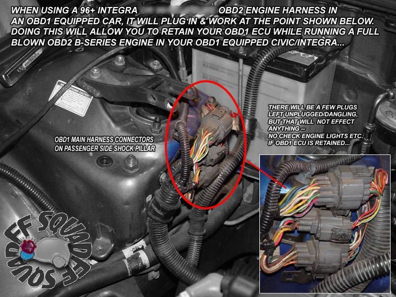

I keep finding conflicting information... I read that I could use my factory obd1 VX shock tower harness with the factory obd2 GSR engine harness. I would have a pair of plugs(1 from each harness) that are not compatible, and don't matter. No rewiring, no changing any of the pinouts. Just use a chipped p28 ecu. Is this correct? Or am I supposed to be using the p72 and repinning the knock and iab sensors? I am starting to think the ecu is bad/chipped wrong and my ignition timing is off.

I'm using the p72 obd2 everything, from the harness to sensors, up until my vx obd1 shock tower harness. Ill try the p72 ecu, and ill clean the iacv, check vacuum again, and check that all plugs are in the right place.
this is one if the things I've been referencing, and then the two plugs on my harness that are not compatible.
