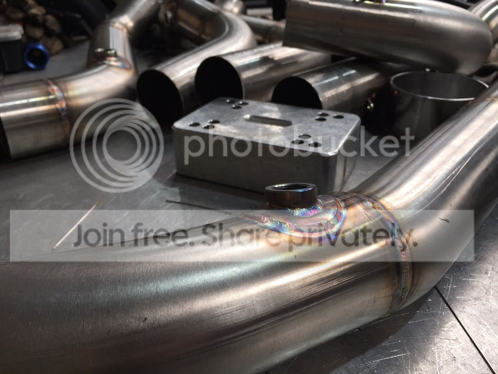

Got to help out at a local Fab shop last week during my regular jobs holiday shutdown. Helped with various tasks and one of which I welded up a set of headers for a Radial Vs. the world Pro-mod. Each primay is 2-3/4" there is a lot of time that went into welding all this up. turned out pretty good .

Heres a few things ive been working on lately ..... Evo 8 Front mount turbo kit. S2000 tubo kit, I fabbed up a 3" to 4" exhaust for a friend of mines LS3 240sx.

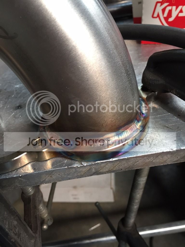

When welding tubes to a header flange which way will the flange tend to warp? Do the ends pull up or does it bow in the middle? The flange will be bolted to a purge block during welding if that matters.
Here is my offering, an engine mount I welded today:
Old 04-01-2017, 10:03 PM
  #898
-Intl Steve Krew
Caoboy's Avatar
Join Date: Dec 2003
Location: Central Valley, CA
Posts: 6,046
Received 183 Likes on 161 Posts
Default Re: ***WELDING RANDOM CHAT THREAD***
I have not welded a header flange but I would assume it will pull towards the welds.
My experience is with sheet metal fabrication, and this is usually the case when something is not secured in a fixture.
Also things like the direction of your weld can change the way the metal warps.
The order in which you weld your runners will also affect it.
Welding out to center brings the heat towards the center, which would more than likely cause it to bow out in the middle.
Welding center out would allow the middle to cool while the other welds are being completed, and will most likely bow in, in the middle.
YMMV and most likely no matter what the flange will need to be machined.
I know you said it would be connected to a purge block, but will the part be clamped/bolted to a flat surface?

I can clamp the purge block to my table if needed (purge block is 3/4" aluminum, table is 1/2" steel, flange is 3/8" SS). Reason I'm asking is that I noticed my flange already has a gap of maybe 1/16" (in the middle) when set on a flat surface. I'd like to try and make any warping from welding work in my favor or at least not compound the gap I already have.
So if I understood you right: Bolt it down with it bowing in the middle away from the purge block, then weld center out, that should tend to reduce the gap?

I would clamp it as flat as possible.
A 3/4" AL block is going to act as a heat soak. Weld a section at a time and let it fully cool before continuing.
Is your purge block as wide/long as your flange?
