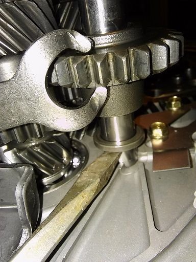

Only had 30 minutes. Got the snap ring off easily. So, there's that I supposed...
Got the stuck bolt out.
Used a 15mm open end wrench to pry on it as I turned it out.The bolt was, in fact, mushroomed around the detent ball.
Left side, mushroomed.
Right side, normal.
Hopefully I can get this cleaned up. ???
What in the hell was I thinking with this washer/spacer? That doesn't belong there. Now I need to figure out where it was supposed to go...
That's as far as I got.

That washer under the reverse spur gear IS in the proper place... leave it alone. Repair your detent bolt holes, re-assemble the transmission and then see if you can cycle it through all gears using a phillips screwdriver that fits the hole in the shift rod sticking out of the back of the transmission. If you are successful in selecting all gears in this manner, re-install your trans in the car. If not, open it back up and take some more pics.

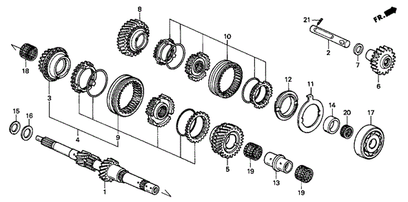

Thanks for the response JRCivic. It looks like it's number 7 on this:
It's not shown in my HELMS manual but the manual I have is for a '98 GSR. That image is for a '95. Either way, It doesn't look like it'd hurt anything.
