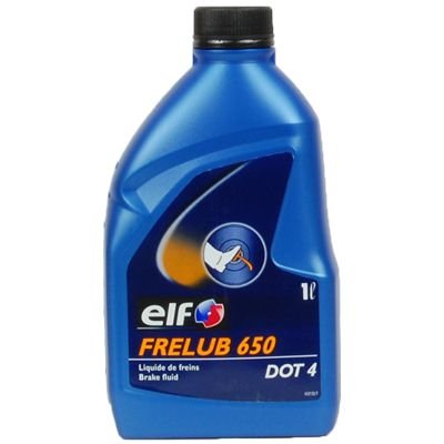

Here's the brake fluid I run on all of my cars with stainless lines except the Integra.
For the Integra, I use this:

As for the brake fluid, I've giving ATE a try. I don't know anything about ELF, but Motul is pretty hygroscopic, isn't it?

As for the RBF 660, no, I've never dealt with any hygroscopic issues with that fluid. The ELF is fantastic. The ATE SuperBlue is "meh".

ELF sounds like good fluid, but what makes you say ATE is subpar? The ATE dry boiling point is identical to ELF, but the ATE has a wet boiling point nearly 50 degrees higher.

Just from racing with it over the years in events. It just didn't seem to last for its boiling point as marked. That's why I went to the RBF for the race cars and ELF for the daily. (I can get the ELF over the counter pretty easily).
