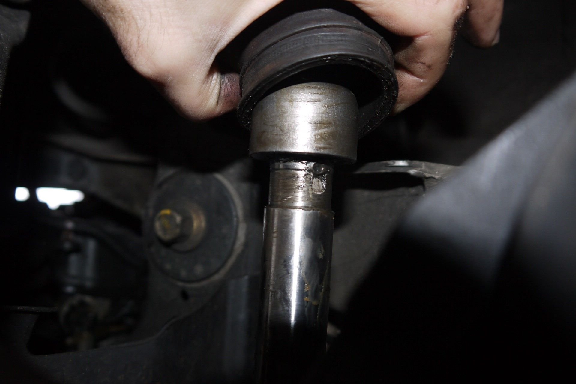

Here is a picture of the "joint" between the inner tie rod the and the steering rack. Probably if I "hammer back" that "punch hole", I will be able to remove the inner tie rod. But then, there is the question: does the steering rack have the necessary grooves for the new locking washer?
I think that for now, I will not replace it. There is still no visible wear in the inner tie rod... although it has already done 215.000km...
