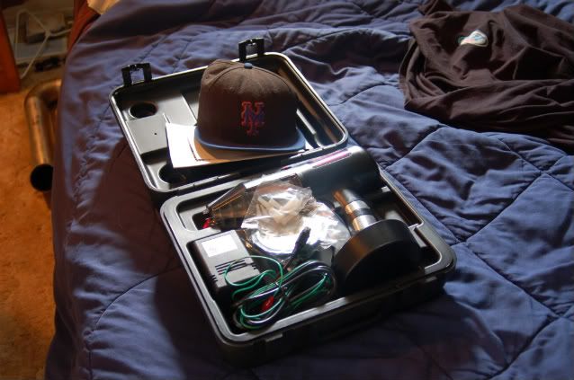

Buy yourself one of these. You will use it way more than you think, and It pays for itself. I got mine for $20 though haha I like working at sears.

The only issue with that is the fact that the powder gets everywhere. So you need almost like a dedicated room, or a well ventilated alcove or something. And to top it off ( I don't know anything about powdercoating, so bare with me) Don't you have to powder coat on bare metal? So if you do then you would need to strip every last inch of what you're coating right? Sand blasting or metal stripper. Sounds easier if you take it somewhere. Or maybe, if you took it somewhere to get it stripped, then did it yourself at home. I'm just rambling.

Well I know Summit sells a paintgun just like that, however you still need to bake it, finding an oven to fit wheels in would be a task. I could do it myself, if I had the resources. The know-how I already have. Sadly no oven that large to take care of the job

Yeah this is true but you save yourself money in the long run.
I fit 16's in my moms cookin oven lol but you have to to them one at a time.
