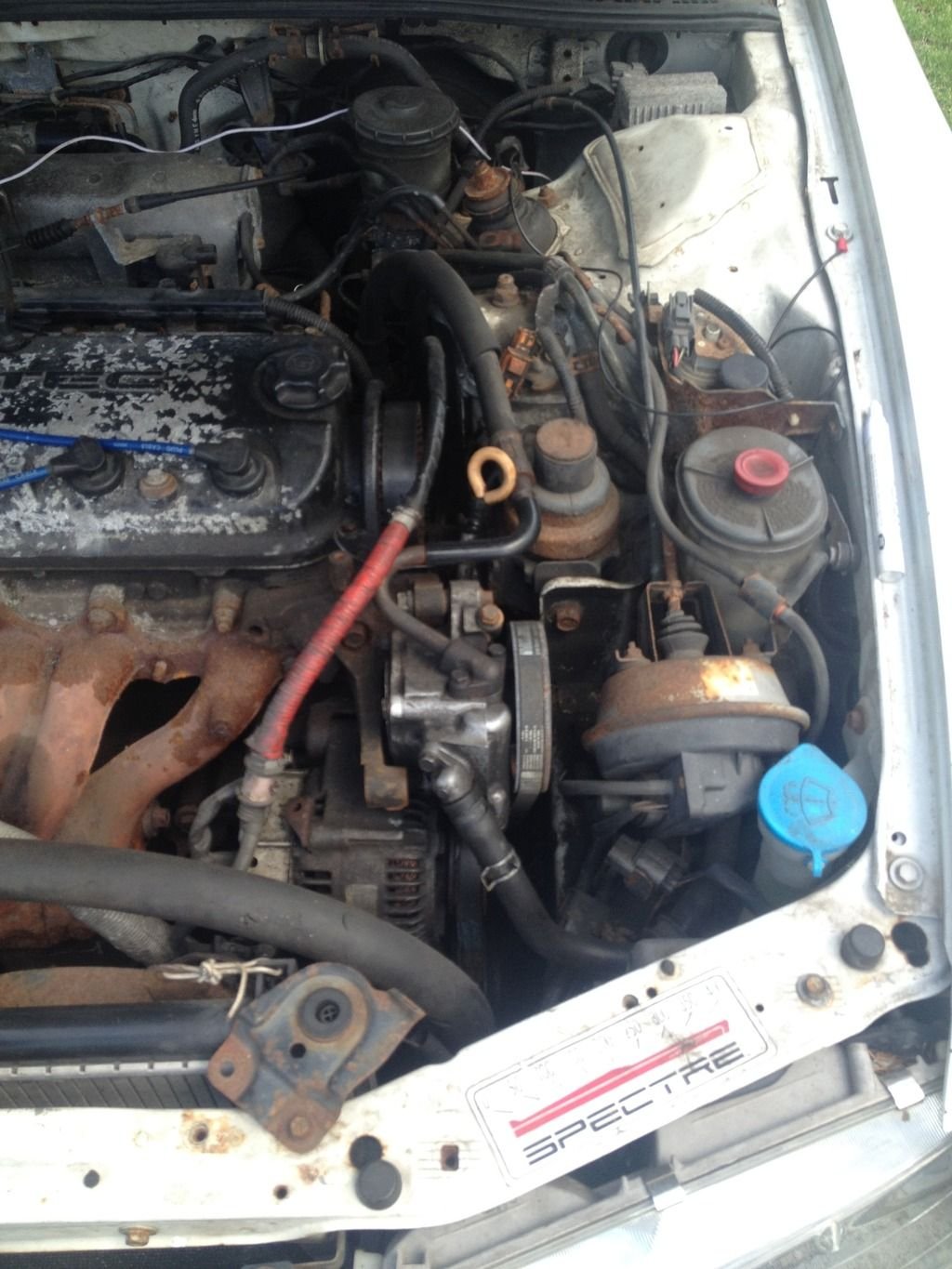

That ground was not working so i fixed it last owner fawked it up
the last owner did not swap the fuel rail so he rigged it lol
