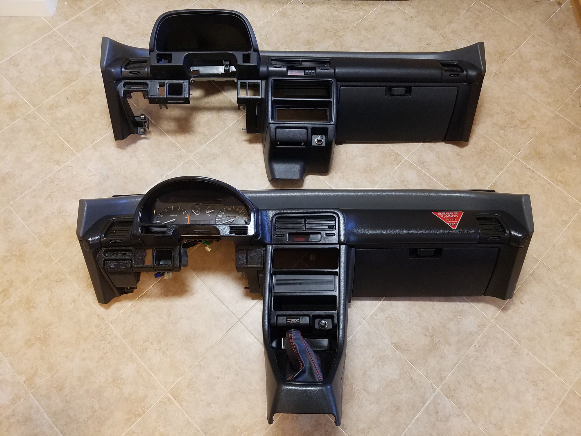

Dash swapped, restored trim back to black.
Dash comparison, suble differences but huge impact on driver visual feel.
Civic
CRX

Default Re: When H met B.
Looks Great! I put a CRX dash in my old hatch and really liked the look of it in there. Glad to see your car coming along so well.
