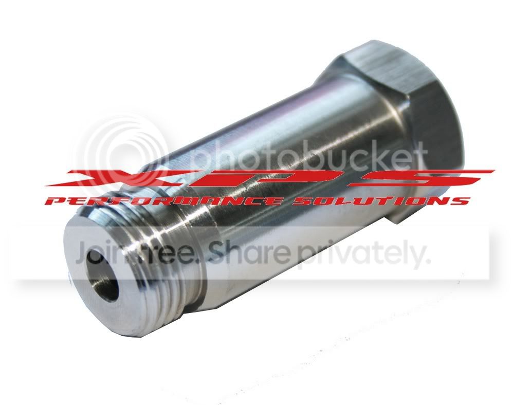

i don't see how seafoam would help. obd2 inspections don't have a gas analyzer. it uses the on board computer to check if monitors are good and no cel is on. you don't need a cat. you can get that spark plug defouler and put the secondary o2 into that. and you should be able to pass that once the monitors are ready.

Default Re: Problems passing MD Emissions! Help!
http://i608.photobucket.com/albums/t...ENG-CELFIX.jpg
hopefully that link doesn't go down. and post-cat is the o2 sensor after the cat.
Old 12-29-2009, 08:03 AM
vlc92189's Avatar
Join Date: Jan 2006
Posts: 1,440
thats a plug defouler? and what is the purpose of that?
the plug defouler will put the oxygensensor far enough from the exhaust emission to fool the computer into thinking that there's a cat in the car. allowing you to pass obd2 inspections without having to deal with putting a cat in. unless the place you take your car to actually looks in your engine bay and underneath your car.
