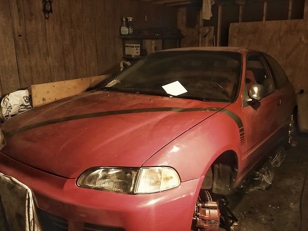

Got the hood on.
Shift **** - Copper H inset in a maple burl that's dyed red and then clear coated. Crafted by my dad.

Sick!
Poor thing needs a wash
