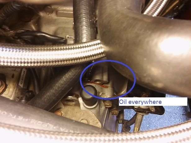

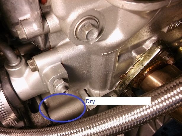

I pulled the distributor and inspected it and the cylinder head for the source of my leak. I noticed that there was no oil on the distributor housing or on the machined sides of the ylinder head around the opening. Looking at the lower mounting bolt hole, I noticed oil in the threads and thought that, maybe, there was some sort of leak through them but, I was leaking a lot of oil. There was no way that much would leak around threads. I also noticed some oil on top of the boss. The only thing above it was the plug. It wasn't even finger tight...
