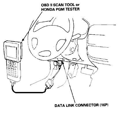

How to pull OBD2 CEL codes
92-95 Civics have an OBD1 ECU, whereas 96-00 Civics have the more advanced OBD2 ECU.
Interestingly, the OBD2 ECU of 96-00 Civics is somewhat of a hybrid system in that CEL codes may be retrieved
either (Method 1) by jumping the service connector (see Post 1) or (Method 2) by connecting a code reader or scan tool to the Data Link Connector (DLC) located near the hood release lever (see below). Method 1 recovers OBD1 codes, whereas Method 2 recovers OBD2 CEL codes, which are preferable as they are more informative at pinpointing the problem.
You can purchase a code reader or scan tool to pull OBD2 CEL codes. Alternatively, you can also drive to AutoZone or certain other auto parts stores that will pull OBD2 CEL codes free of charge.
When you pull OBD2 CEL codes, you will find that they look very different from OBD1 codes. OBD2 CEL codes follow this format: P followed by a 4 digit number (e.g., P0420).
In the charts below, you will find lists of all OBD2 codes for 96-00 Civics and 96-97 Del Sols.
You will also see numbers in parentheses. These numbers indicate the equivalent OBD1 CEL codes that are retrieved by jumping the service connector
The last diagram in this post describes how to clear CEL codes from the ECU/reset the ECU.
