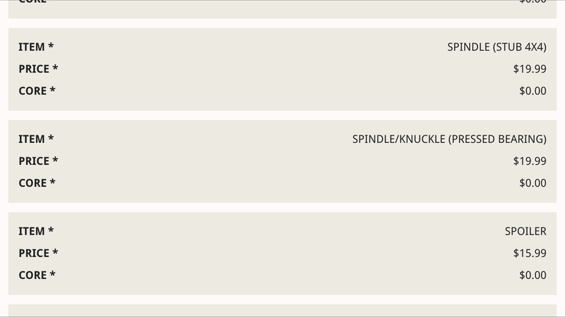

Don't buy new knuckles! Just go to the local U Pull and Pay and grab a set of a junker. You can use any 92-95 Civic EX, 94-95 Si or 94-01 Integra. Should cost you just under $50.

Thanks, I appreciate the help. I was getting a little pissed when the adjuster was telling me that they would not cover the alignment.
I will look for some used spindles around here. '94-'01 Integra might be my best bet.
Just nervous about the possibility that the car I get them from may have a bent spindle as well?

Looks for a car with no damage or rear end damage. Your more likely to find a knuckle with a bad ball joint or wheel bearing then a bent knuckle.
The yard will mark the part and I believe you have sixty days to return it for store credit. As another poster said it should take about 20 mins, maybe up to an hour, to remove and replace a knuckle. There are 7 nuts per side including the wheel lugs to remove. The hardest part will be separating the ball joint from the knuckle.
Pick the part and replace it that same weekend. Get another alignment. If you found a bad part, rinse and repeat.
Local guy has a '99 Integra, w/ ABS, pass side knuckle for $75. Nothing else...
Dude is high.
U Pull and Pay price. You'll have to put in some labor finding/pulling the knuckle, but damn! a $50 mark up. Nope.

Originally Posted by eHMxhACk
Dude is high.
eH.
Damn! Problem, is am likely having to drive an hour, to then put in the labor to pull it, and then drive an hour home. The $75 guy is in my back yard. I think I will post a Wanted in the classifieds here...

Default Re: Front End Alignment Questions - Camber Issue '94 Si
If the guy has a good conditin knuckle removed thne go with it.
and the junkyard is an hour away+ labor,
Driving your civic you wont waste much gas, but will be about a half day journey.
The spinlde is $19.99+ core + tax + all the other stuff they charge + entance! + 2 hours of gas.
Vs
$75 right behind you.
Looks like this is also used on 94-97 Del Sol...
