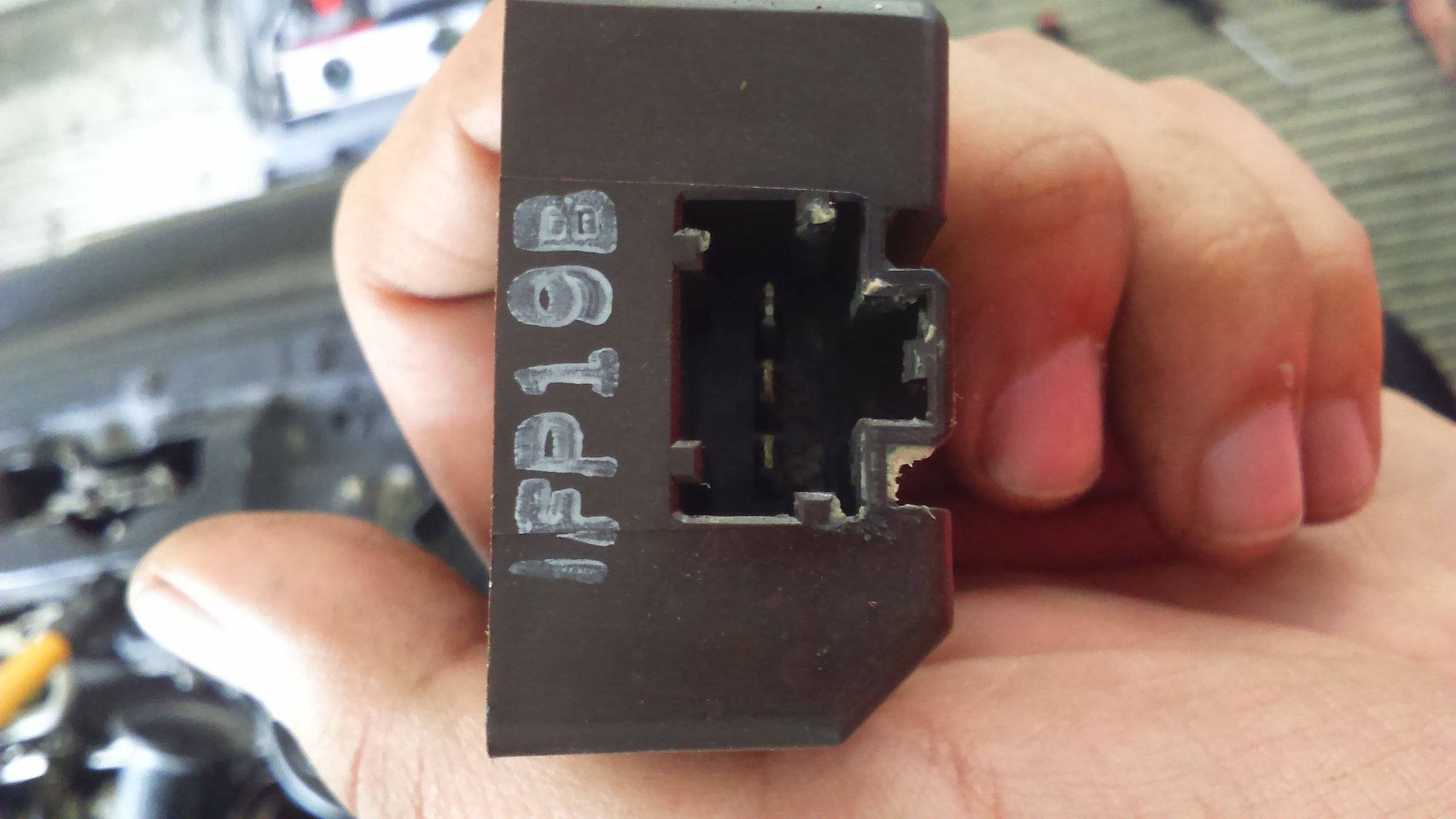

i did take the ELD form the fusebox
Where i can find the same ELD shown in the pictures below?

UPDATE:
New ELD, no more P1297, But the other three codes are still there:
