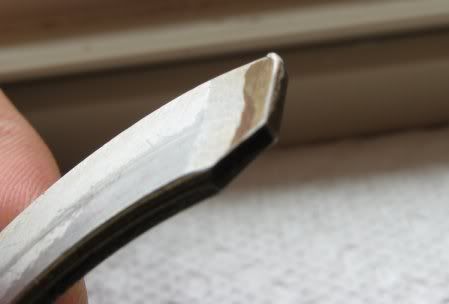

Was removing the rod bearing cap on cyl. no. 1, and this semicircular piece of metal fell out of somewhere, didn't see where it came from, and can't for the life of me figure out where it goes..
It looks like it's broken in the picture, but it's not- that's just dirt/grime.

It's about the diameter of the cylinder wall minus the sleeve, and I can't see any possible spot it could have come from.. what the hell?
