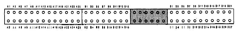

Plug the main relay connector into the main relay, if unplugged.
Turn key OFF.
Unplug ECU connector A.
Turn key to ON(II).
Use a jumper wire to ground the Grn/Yel wire at pin A7 in ECU connector A to the metal frame under the dash.
Does the fuel pump run as long as pin A7 is grounded?
Old 07-17-2016, 02:14 PM
Redder's Avatar
Join Date: Jul 2016
Posts: 50
Default Re: 92 Civic DX Cranks but won't start
This might be a stupid question but is there anything I can use instead of a jumper wire? I don't have one on hand.
