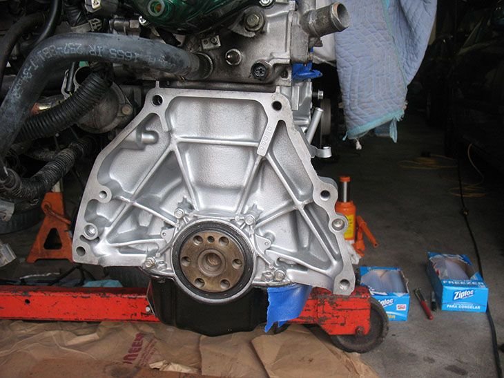

Here are some pics from my own swap that was done roughly 2 years ago, You'll notice I also opted to recondition and paint my engine bay...not necessary, but it makes a big difference. And on a side-note, I wouldnt recommend XTD clutch products as they seem to have a high failure rate based on threads ive read, but I also seem to have gotten lucky, mine has yet to exhibit any problems. I hope the flood of images isnt too much, and I dont intend this as a thread-jack of any sort...I just hope the visual cues will help you along. Good luck man.
Full engine/trans pull.
didnt realize my rear main was bad at this point...regret not doing it then.

Old 02-22-2016, 12:04 AM
