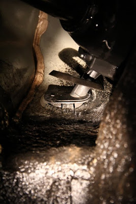

After finding the leak in the window seal I had someone come out and replace the seal and rear windshield. There is a clip about 1 ½ inches long that holds the rubber seal to the car near the bottom of the windshield that was not connected. It was definitely what was causing the water to come in, or so I thought…
After the next rain storm we had, I checked the carpet behind the seat again and sure enough it was soaked. I ripped apart the trunk again and found about the same amount of water as before. My wife and I did the windshield water test and there was nothing coming in this time. After dropping a few f-bombs and some other colorful words I noticed that the water in the trunk had a lot of sediment in it. It looked like it was coming from the rear, driver’s side wheel well. I took off the tire and blasted the hose all around the well and saw a small but steady stream of water going in the trunk. After some closer examination of the well, I found this plug that was not connected to the frame correctly. It’s the cord that connects the gas tank cover release switch in the front of the car to the gas tank cover. I put the hose right up to it and definitely found the problem.
I emptied over half a bottle of silicone sealant around the plug after putting it back in. Hopefully that’s it.

Well, that didn't work. It rained again today and there's still water getting in. I let the sealant dry for two days so there shouldn't have been a problem there. The water is definitely getting in from the wheel well somewhere though. I sprayed the hose again tonight and was getting the same result. Are there any recommended wheel well sprays or sealants I could use?

Default Re: 2006 Civic Hybrid water leak trouble
Check around the clips the hold the bumper cover you still need to find the leak and seal it before you can use undercoating.
You should be able to follow the mud trail, if water is kicking up from the wheel well follow the mud dust or the wetness back to the leak point.
Go back to where you don't see any moisture and see where it starts, draw an imaginary circle around the spot and look at ever possibility, do not rule out water making weird angles it can be coming in from a plug hole or around a plug, the moisture in your case should point to it.

I see from your pics you are not the first one to be looking for the leak or did you use the spray can undercoating, I use that after I find the leaks to seal over the area. Good Luck.

I did find another spot that was open; the gas cap housing was not sealed on the inside of the wheel well. There was a half inch gap all around the housing. I tried to get some pictures, but I couldn't squeeze my camera that far into the well. Anyway, I sealed around that and there's definitely not as much water getting in, but there was some after driving home yesterday.
I'm sure I'm not the only person that has looked for the leak based upon the existing spray.
